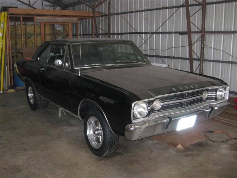

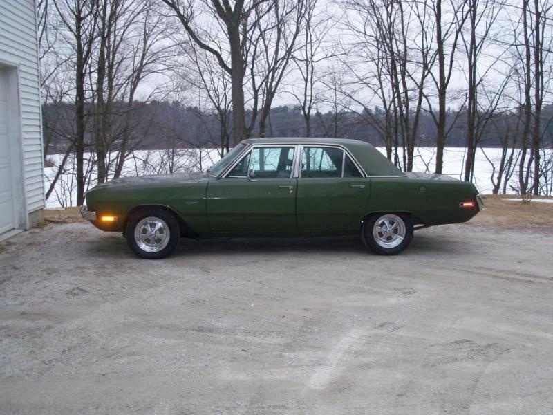

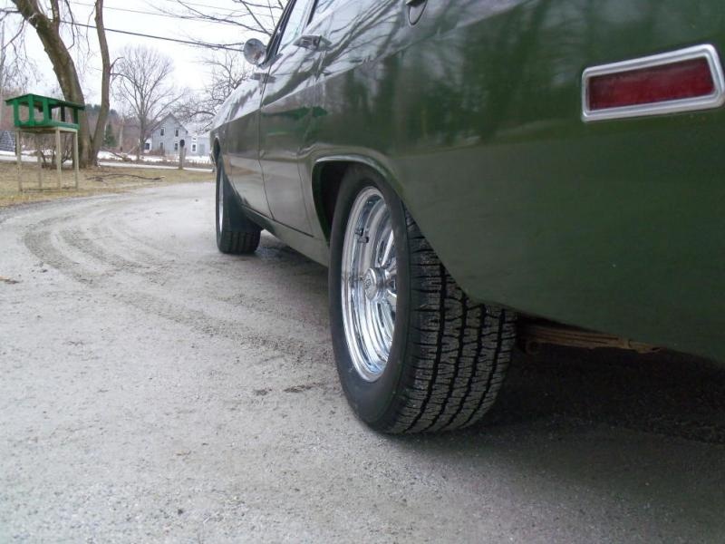

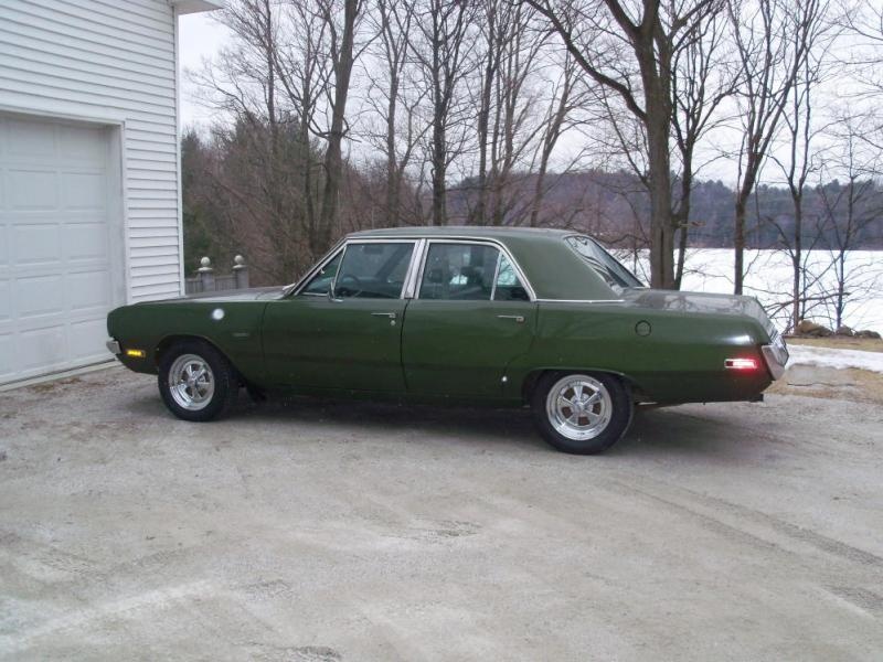

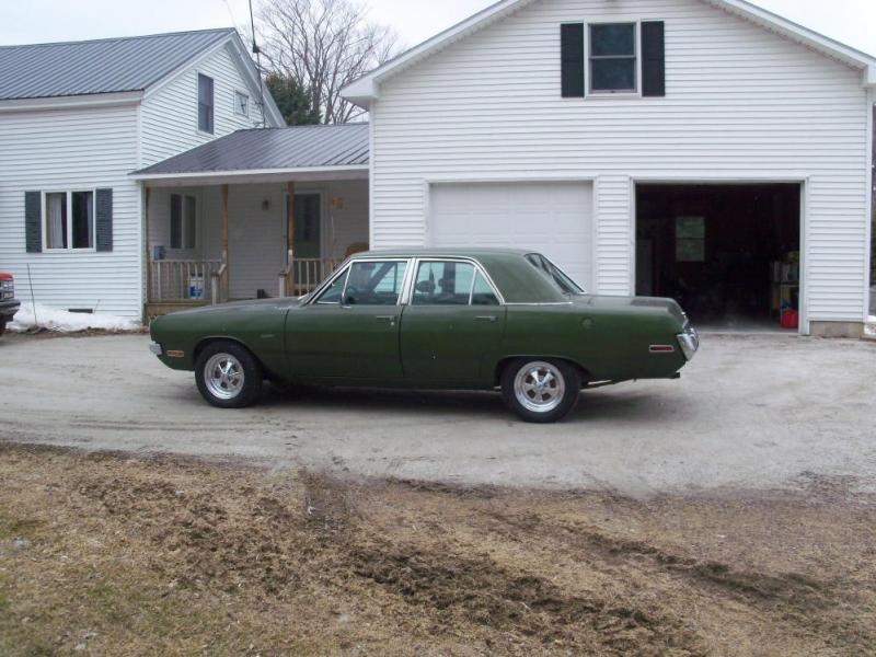

oops sorry got carried away looking at that cool duster anyway mine are 15x7 dodge diplomat 235-60-15 bfg drag radials and stock 14x5 195-70-14 fronts el-cheapo got the drag radials off craigslist for 125.00 went home and sold the chevy wheels for 100.00 25.00 for the rears pretty frugal huh?View attachment 178163

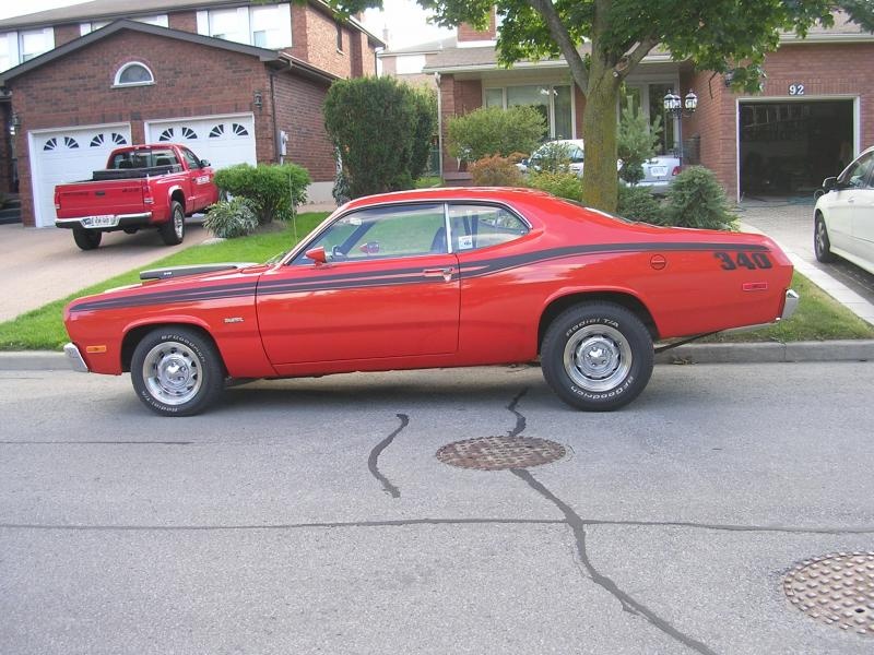

here is pic of my 1973 duster with BF Goodrich radial T/A 275/60/15 on the rear and 225/60/R15 on the front.
On stock rear end with stock 15 inch rims
here is pic
