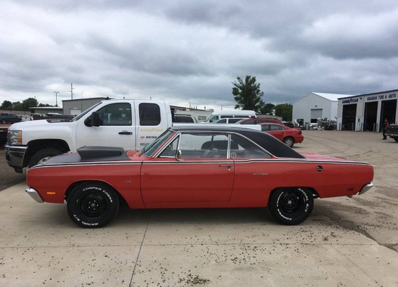

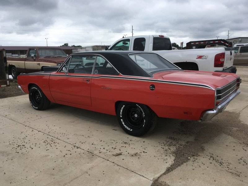

29X10" TREADED SLICKS / 68 FORM S FASTBACK

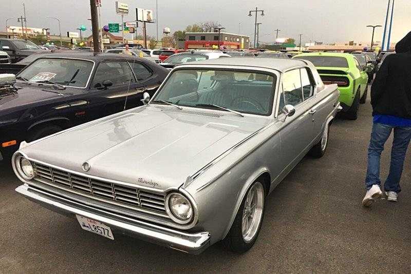

Does anybody know what kind of wheels these are? I'm thinking of slapping em on my dart this summer but I don't know what they're called.
That looks killer. What backspacing/offset did you go with? Loving the stance.
I’d have to put a tape on it to be exact but if I recall it’s somewhere around 6” on the rear with an uncut 8.8 and 4.75 on the fronts.
In front or in back? waiting on spacers to bolt on the rears. 18x9 245/35 in front. Soon the be 18x10 285/35 rear.
Would have preferred 255/295 combo but found just too good a deal to pass up.

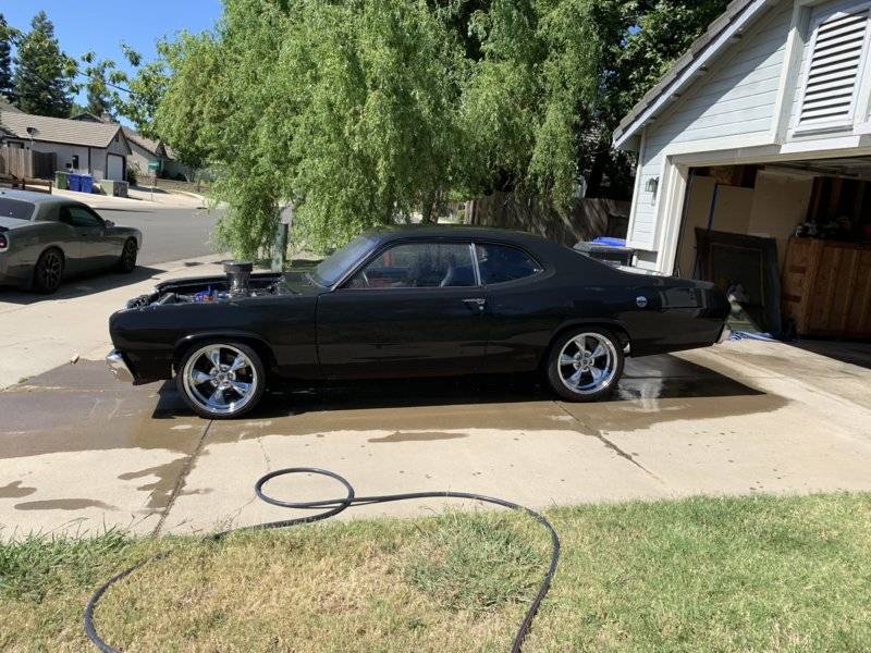

Car year and model: 1974 Duster
Front
Wheel Brand: American Racing
Backspacing:6”
Tire size: 245/35/18
Suspension Mods: N/A
Rear
Backspacing:6.5”
Tire Size: 285/35/18
Suspension Mods: Spring relocation, Lip trim, 2” blocks.
