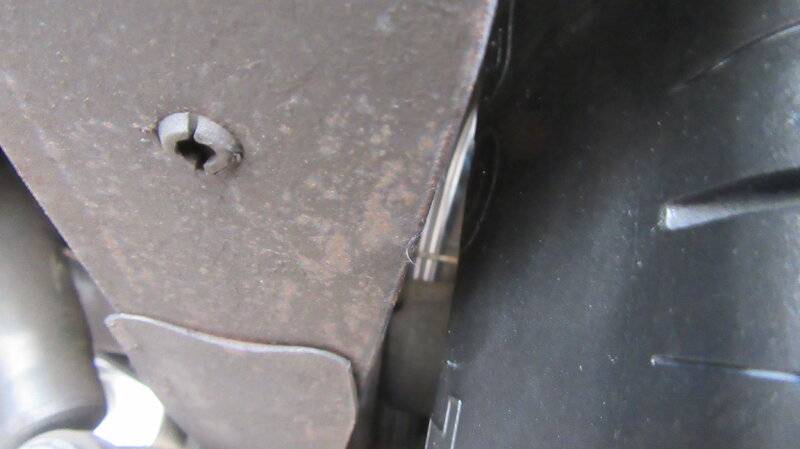

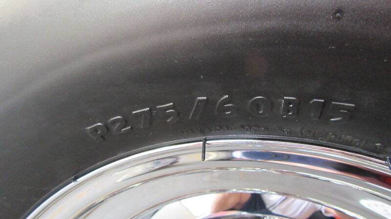

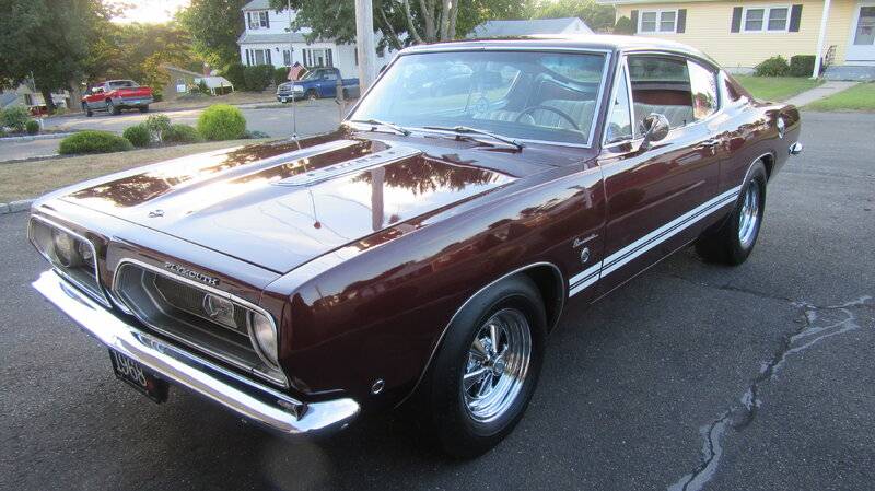

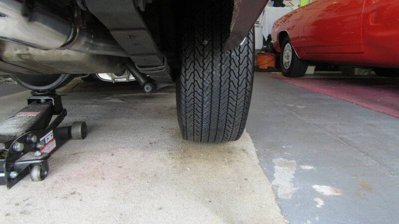

68 Barracuda FB. 100% stock suspension. Rear: Pro Trac 275 60 15 mounted on Cragar SS 15 x 8 w/ 4/25 back spacing. 5 on 4 bolt pattern. They fit perfect. Plenty of room between the tire and the leaf spring.
When I do the fronts, I will continue this post.

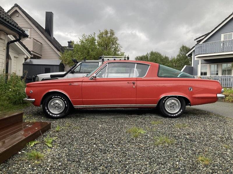

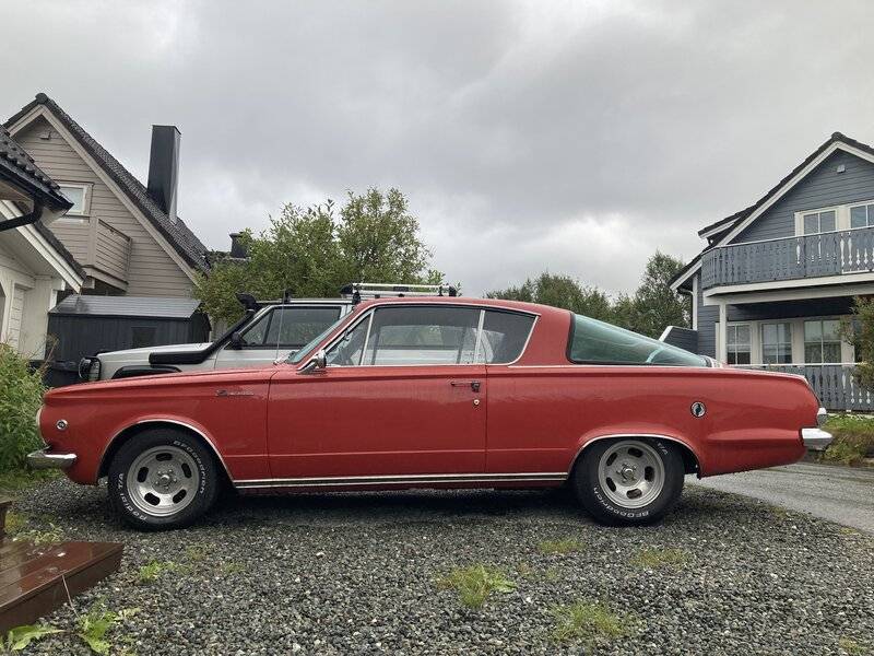

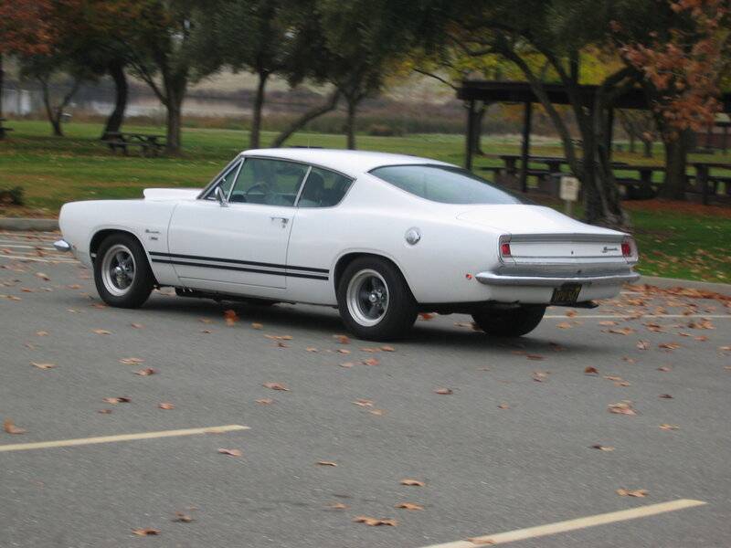

1965 Plymouth Barracuda.
Old setup:
14x7 rims, backspace 3 3/4. 215/70-14. Some rubbing in the rear in speed bumps.
New setup:

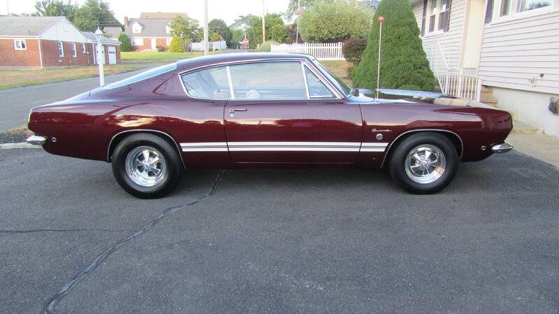

14x5,5 rims, backspace 3 3/4. 205/70-14 front, 235/60-14 rear. No rubbing what so ever!

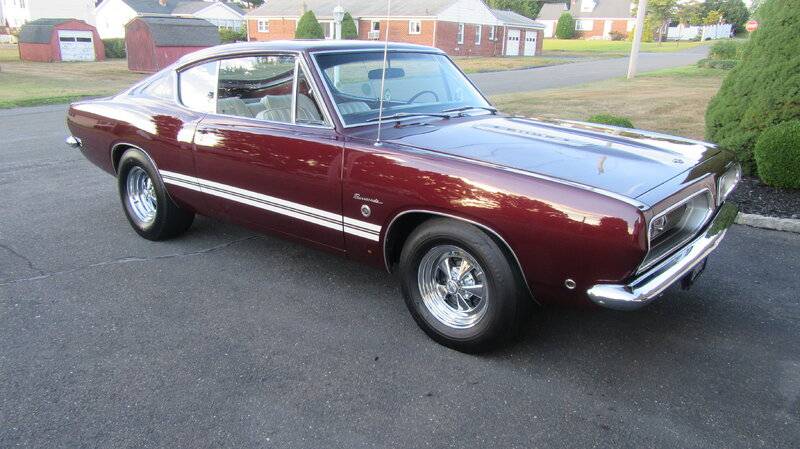

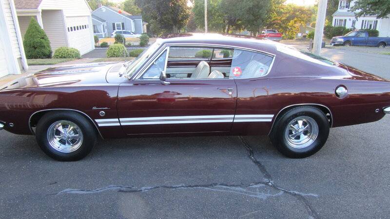

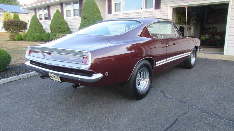

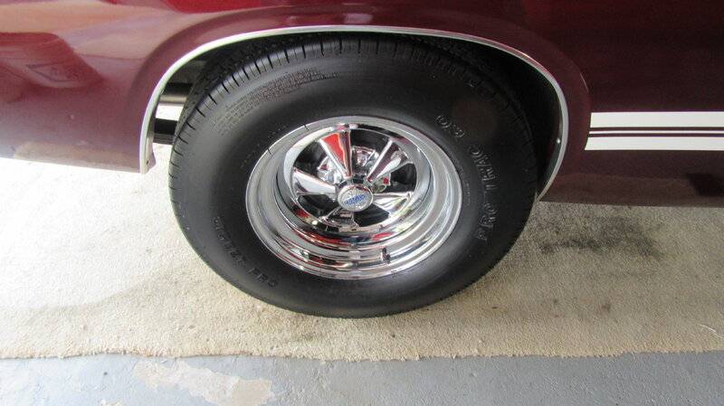

Finally, after 8 months of searching for wheels and waiting for tires to be manufactured, my tire/rim project is complete. Rear: 275 60 15 Pro Tracs on 15x8 Cragar SS's. Front E70x14 Firestones on 14x6 Cragar SS's. Plenty of clearance all the way around.
