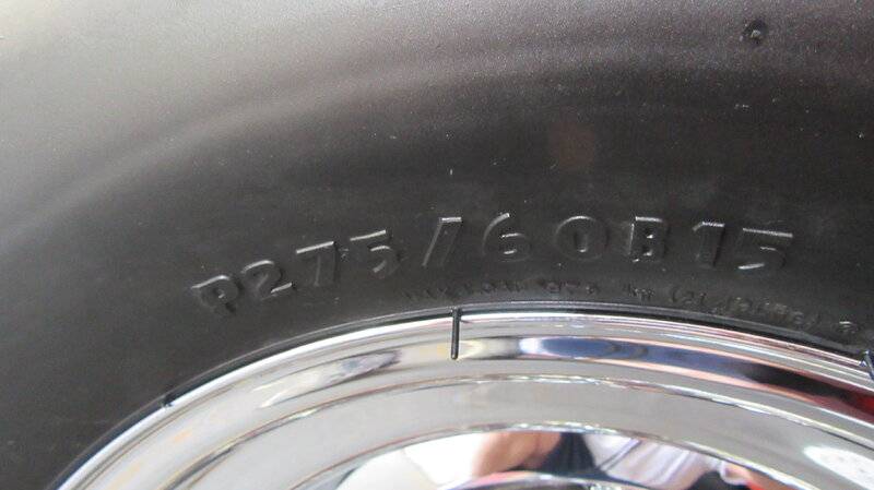

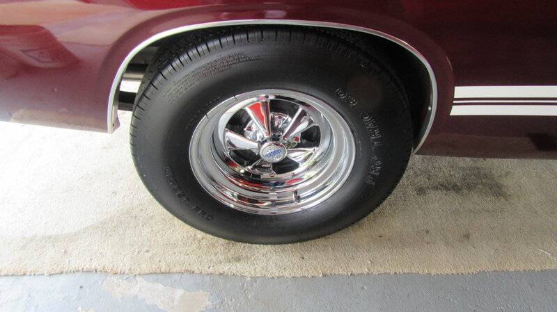

68 Barracuda FB. 100% stock suspension. Rear: Pro Trac 275 60 15 mounted on Cragar SS 15 x 8 w/ 4/25 back spacing. 5 on 4 bolt pattern. They fit perfect. Plenty of room between the tire and the leaf spring.
When I do the fronts, I will continue this post.

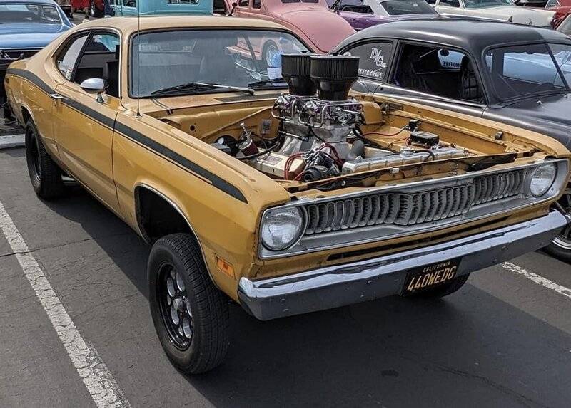

Car year and model 1971 Duster
Front
Wheel Brand: Vision
Backspacing: 1.75”
tire size: 165/80-15
Suspension mods: 26” leaf springs, WAC Customs 3”drop axle
Rear
Wheel Brand: Vision
Backspacing: 4”
tire size: 275/60-15
Suspension mod: Dana60 w/SS springs.

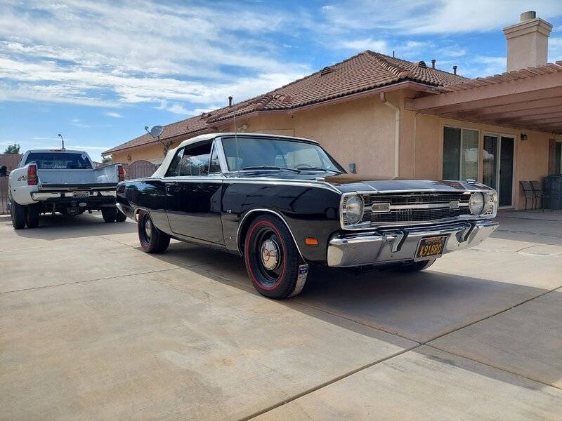

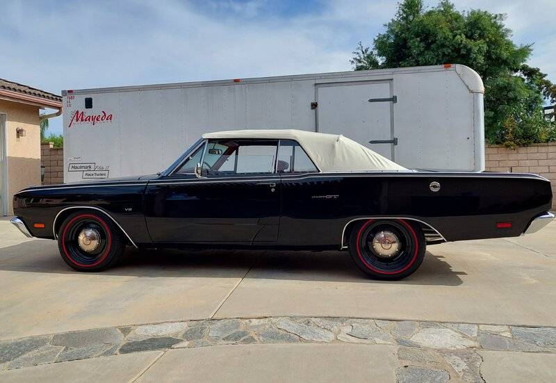

1969 Dart GT Convertible
Front
Wheel Vintiques
15x6
3.75 BS
215/65-R15 (Diamond Back Redline BFG)
Lowered 1"
Rear
Wheel Vintiques
15x7
4.25 BS
235/60-R15 (Diamond Back Redline BFG)

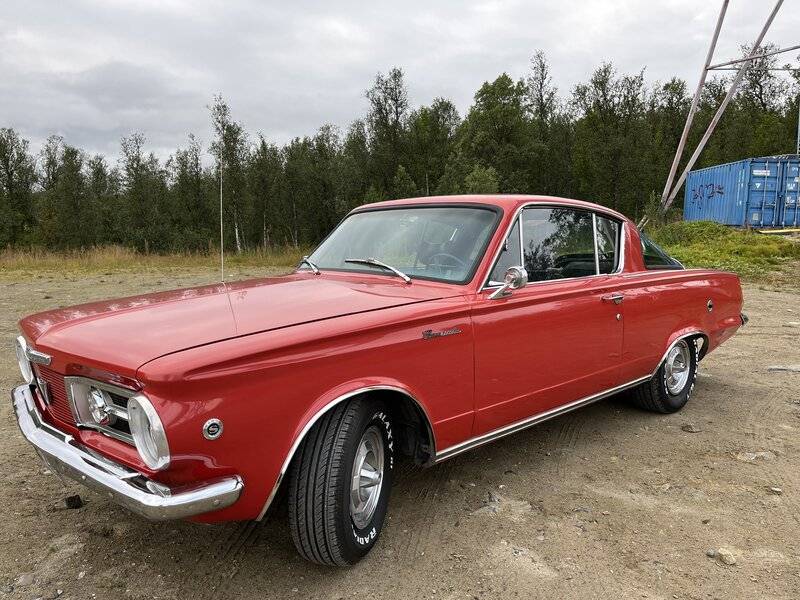

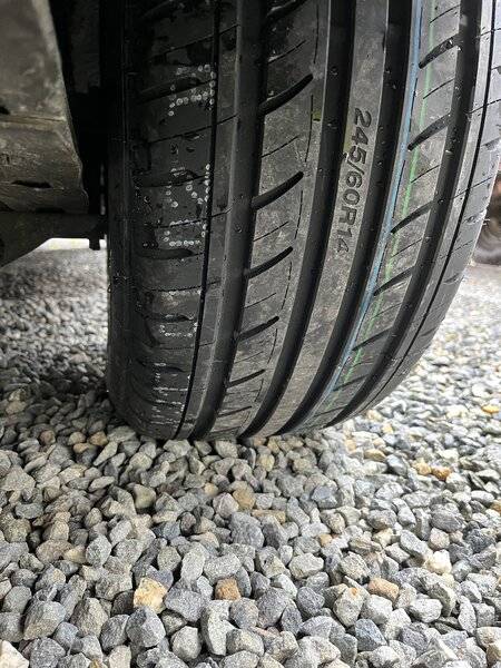

Here is (I think) the largest wheel combo possible for stock 1965 Plymouth Barracuda: Front I have stock rims 5,5x14, BP 3 3/4 and 205/70-14.
Rear I have WheelVintiques 61 Series 7x14, BP 4 1/4 and 245/60-14.
I have maybe 1/4inch from inner wheel to leaf spring, and no rubbing outside what so ever. And both sizes are within 1% of stock size 195/75-14!

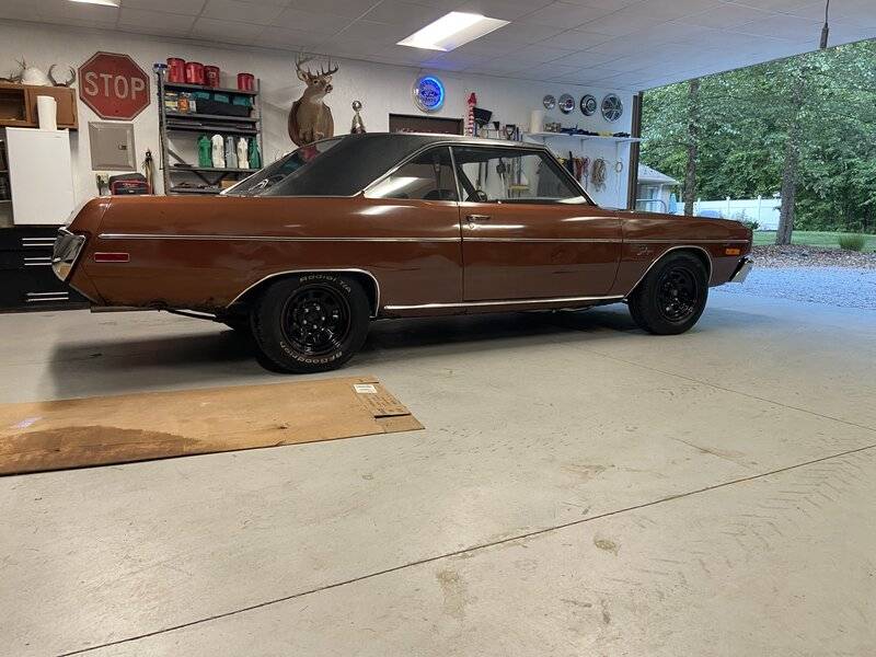

Figured I would post my new budget wheels.
1973 Dodge Dart
235 tire with 15x7 wheel with 4.5”
Back spacing in the back.
Don’t remember what’s on the front.
Wheels are Crager D windows that were $70.

Assuming big bolt pattern. I generally don't care for black wheels, but those look good on your car. Price is right, too

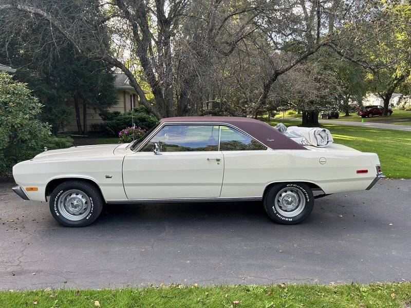

1975 Valiant Brougham. I need to get the car aligned, so no trim rings yet. I kind of like the look without them, so far.
Rear - 245/60/15 on 15x7, Front - 225/60/15 on 15x6. We will see how it sits after I get the interior in and the get bumpers on.
