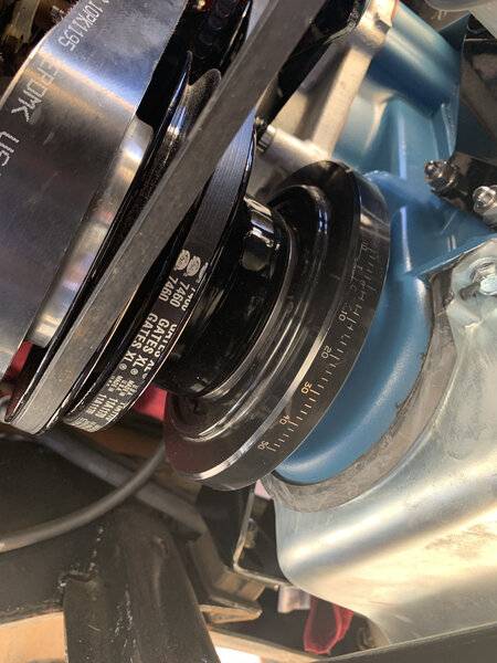

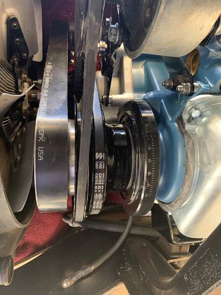

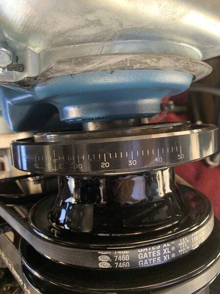

Anyone using the Power Bond PB1004SS sfi balancer. Its much thinner than the stock 340 balancer and sticks out a 1/4 inch more than the 340 when installed. It seems like its not drawn in all the way. does anyone have an installed image .
I using one no issues at all, unfortunately it is installed and I don't have the energy to crawl under the car to take photos..
Did it draw in close to the timing cover near the timing marks. Mine sits out almost a 1/2 inch.
Mine went within a 1/4". Mike @ B3 Racing Engines built mine and he knows these pretty well.
