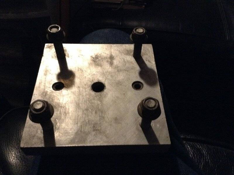

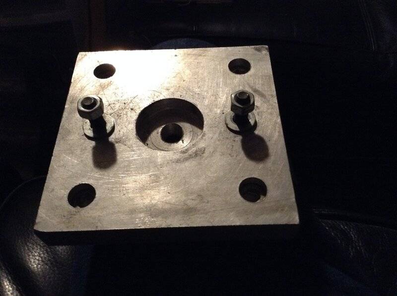

My first one, I made for my d150.

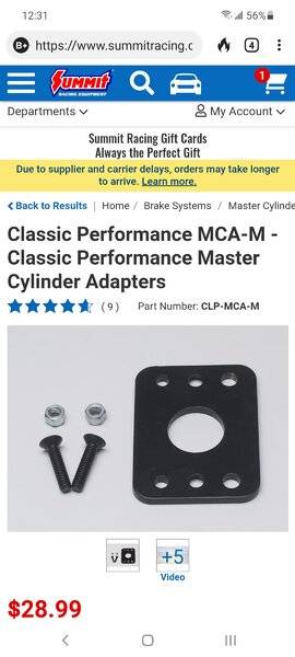

Second one ,I bought from Summit Racing.
i have one i machined out of aluminum for my truck around here somewhere i am not using anymore. it worked well

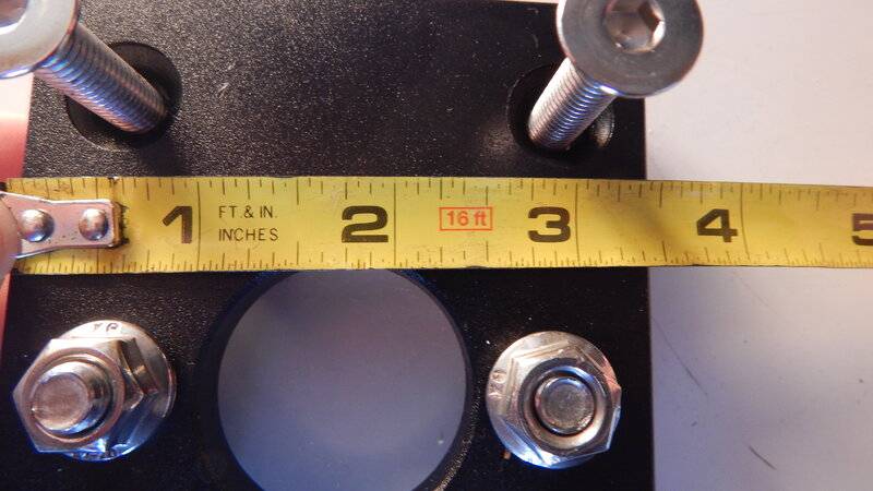

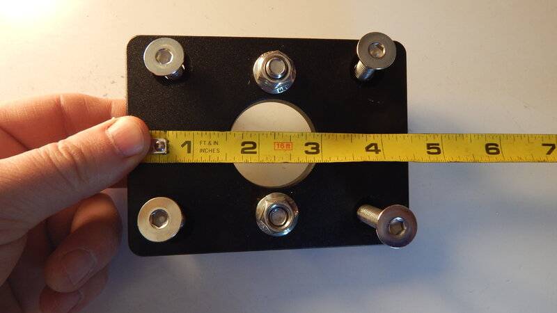

my pattern on the truck seems to be 3.5 x 3.5" on the 4 bolt pattern to the fire wall
The adapter plate on my '72 is about 4 1/4" by 3". I didn't install it, don't know where it came from.

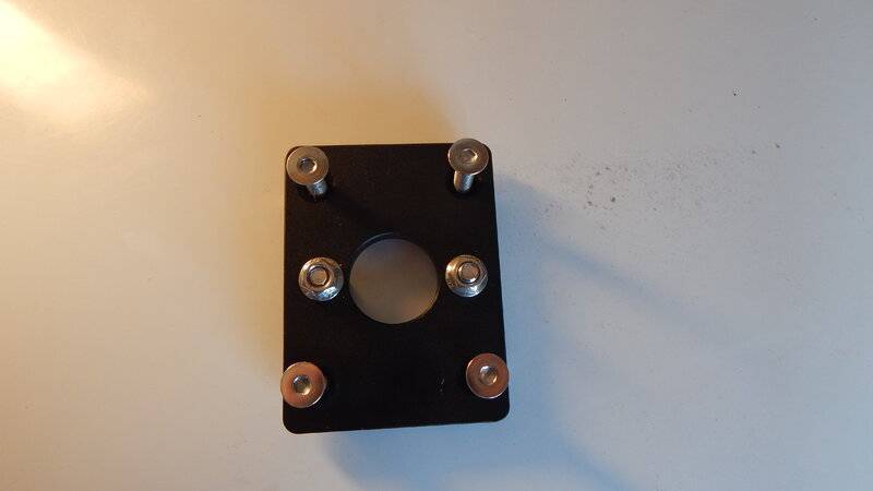

I used the normal 4 bolt to 2 bolt adapter from Mancini on my 1977 D100, when going from power to manual,same adapter as I used on both my A bodies. I used a 1.0625" and the pedal is really hard, with very little travel. Adjust bore size to suit your preference for pedal feel..I think power equipped vehicles had a different pushrod bolt location in relation to the pivot.

As a matter of fact I just remembered where it was. It measures about 3 3/8 horizontally and 3 1/2 vertically on the bolt centers. just throwing a tape measure to it. nd the aluminum is about 1/2 thick. I still have the aluminum master cylinder with 15/16 bore also. I ran it for a short period of time when I had a 93' cab with stepside bed stroker big block. I had to ditch the power booster to clear the valve cover. I made this around the year 2000. i dont think you can buy them anywhere

and sorry for the poor quality pictues above i took them in a dark garage. but it will clean up real nice with some scotchbrite and look like new again. its been gathering dust for 20- years
