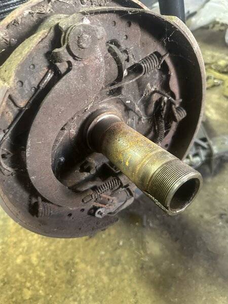

Side note: rear bearings are definitely lose, lots of play , only 82000 miles on this truck but it’s hard truck use.
Gonna replace them since it’s a part. All new stuff, but are Timken bearings still pretty good? Options are them or National Bearing. Staying away from the off name Chinese junk

National is China.
National is China.
Good to know. So the tried and true Timkens it is.

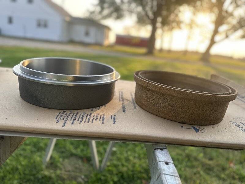

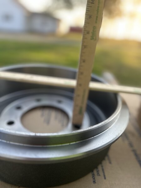

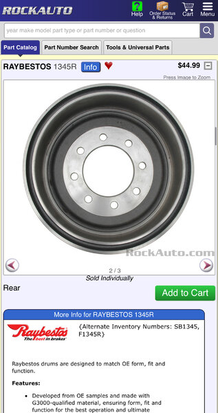

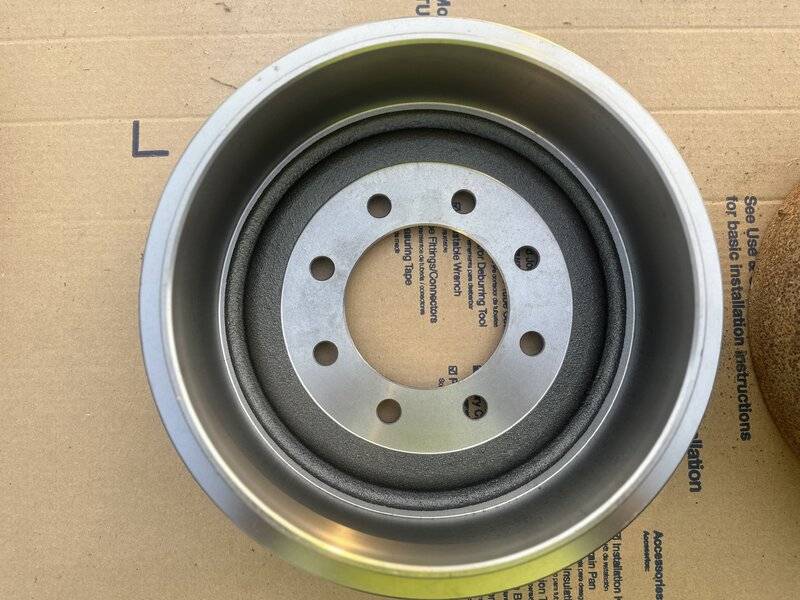

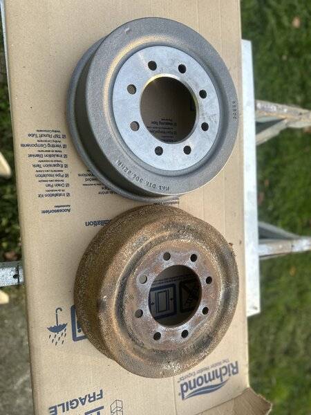

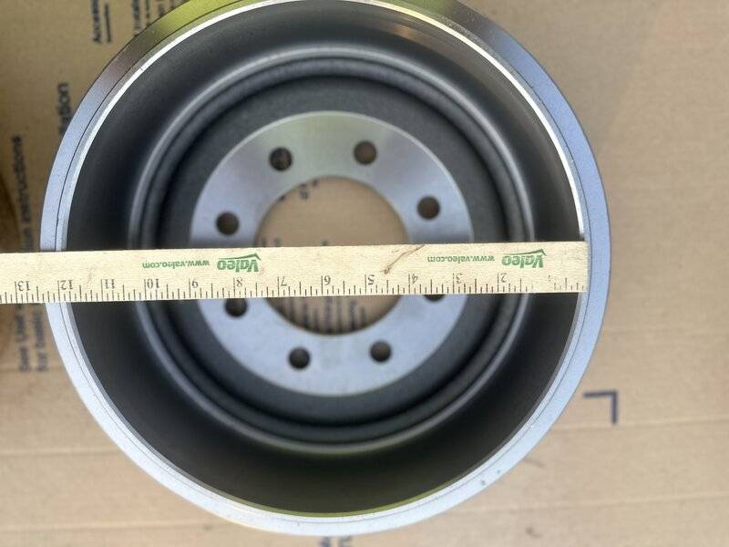

So thoughts everyone?
Obviously the original drum is the rusty one. New is what Rockauto sent me. The lack of lip/groove is the only difference it appears. No one local carries the 12x3 drums. What rock auto showed online in images looked correct but what I got is different
Same drum, just machined differently. Ride on.
