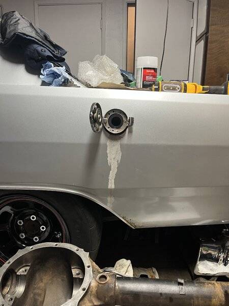

Finally found my promatic for a great deal! It’s from 1998 all original in the box.

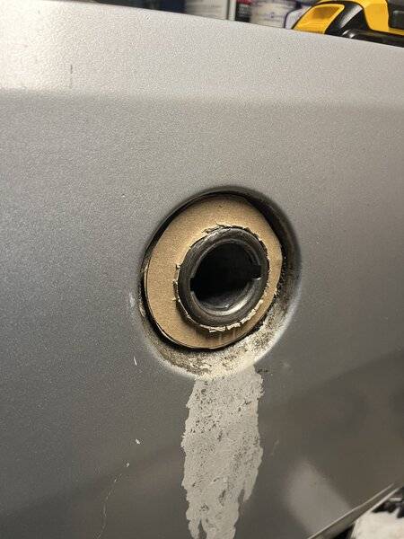

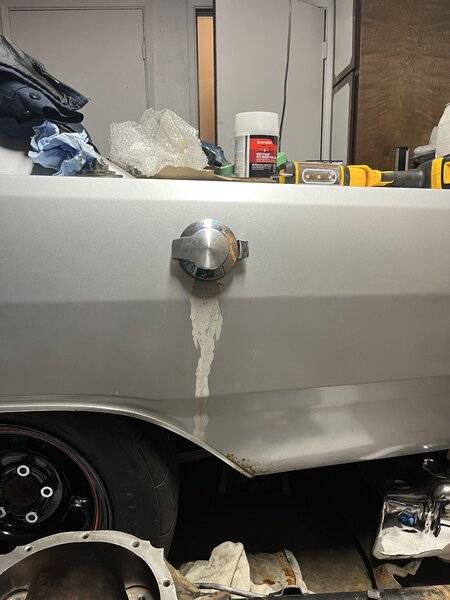

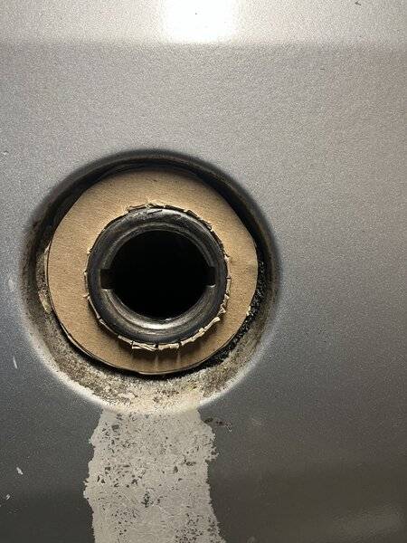

Flip top. Cardboard template to locate the holes. I used three factory holes in the fender, and 1 factory hole from the flip top. Drilled two holes in the cap and three in the adapter. I like it.

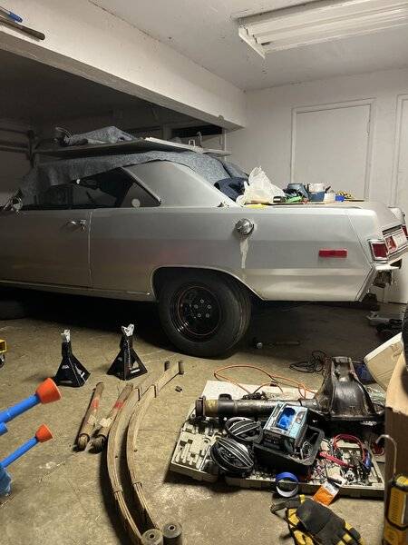

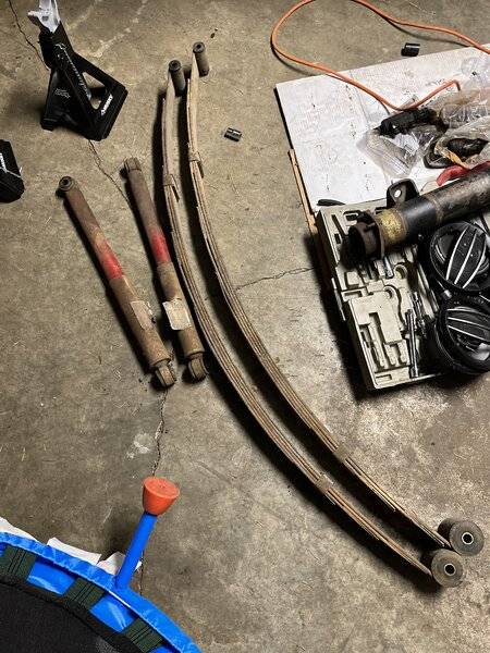

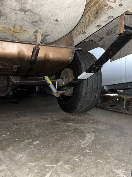

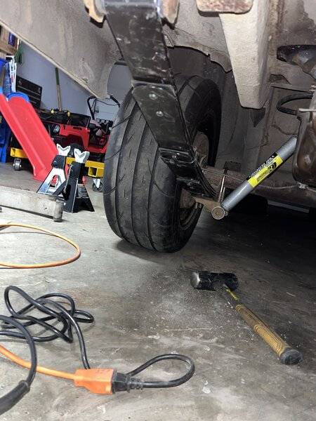

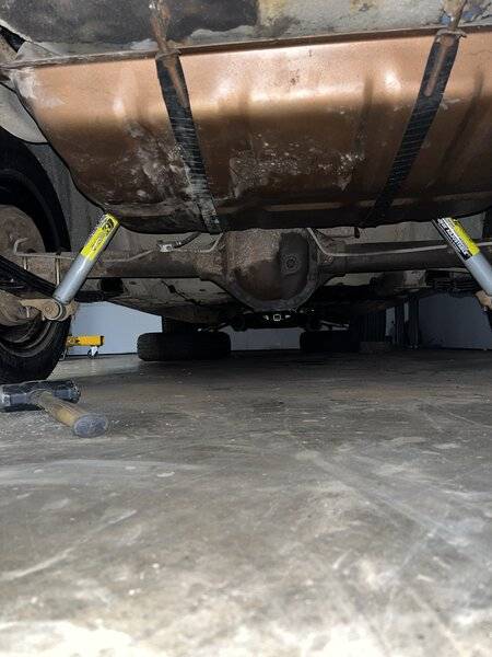

It was all going good until a shackle bolt snapped on final torque. At least the springs and shocks are in. I didn’t order new shackles on purpose, I planned to run an offset shackle on the upgraded rear end. So much for that.

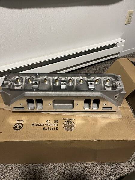

My Christmas haul from the wife and kids. Also got a 3/8 sending unit from my brother and my Mom got me new master to prop valve lines so I can mount the lightweight master from Dr Diff.

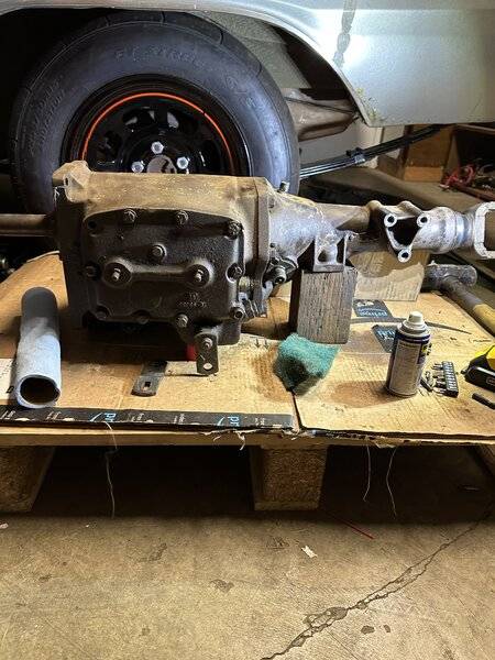

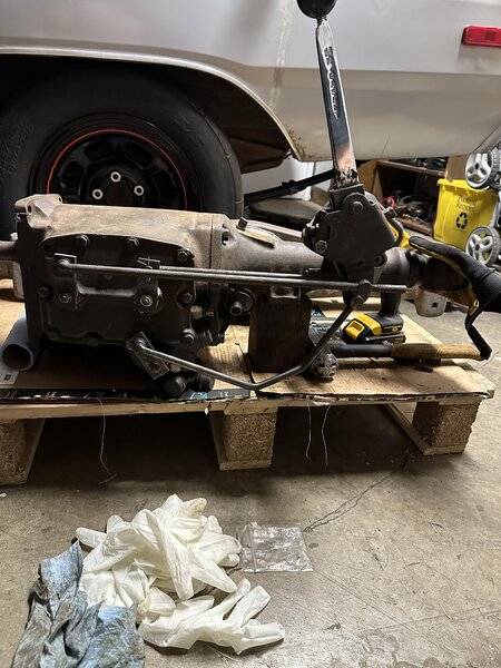

Long overdue update: We are going 4 speed. I got a 1:1 A833 from a 73 340 car, and I just put the Mr Gasket short shifter on. I’m still on the hunt for a bellhousing but I think I have everything else for the swap.

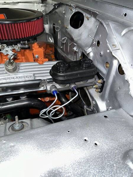

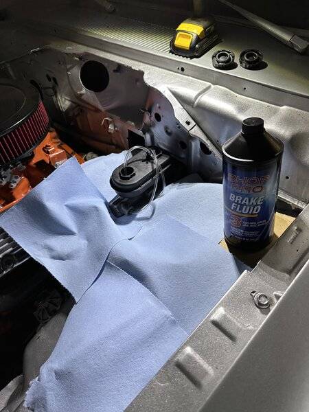

New @DoctorDiff master cylinder and inline tube lines installed with the 4 speed pedals from @MOPARMAGA, they fit the project perfectly, not even going to paint them.
had to fight the spring on the pedals. It’s the HD spring too, heavy motherfucker.
Then the adjustable brake master pushrod needed to be polished to slip on the brake pedal bolt. Works great after that, very solid piece.
I still need to bleed the brakes but I have solid pressure.

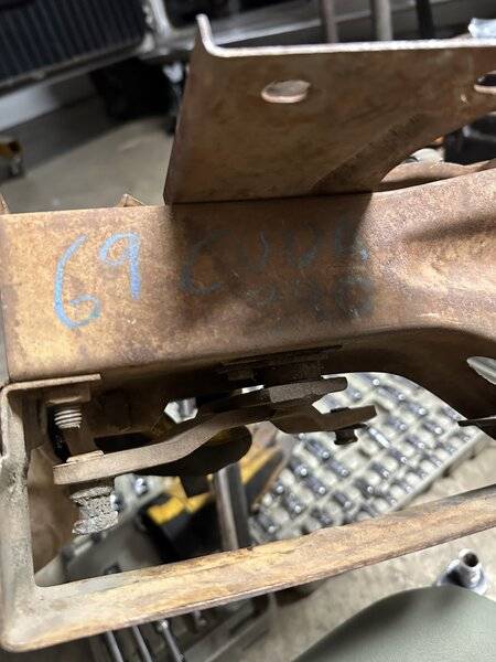

That does look like a ***** of a spring. Is that for the clutch pedal?
Yeah the 340 and bigger hipo motors got an extra support and big *** spring. I am going hydraulic, so I don’t need the spring, but I’m keeping the extra support installed.
