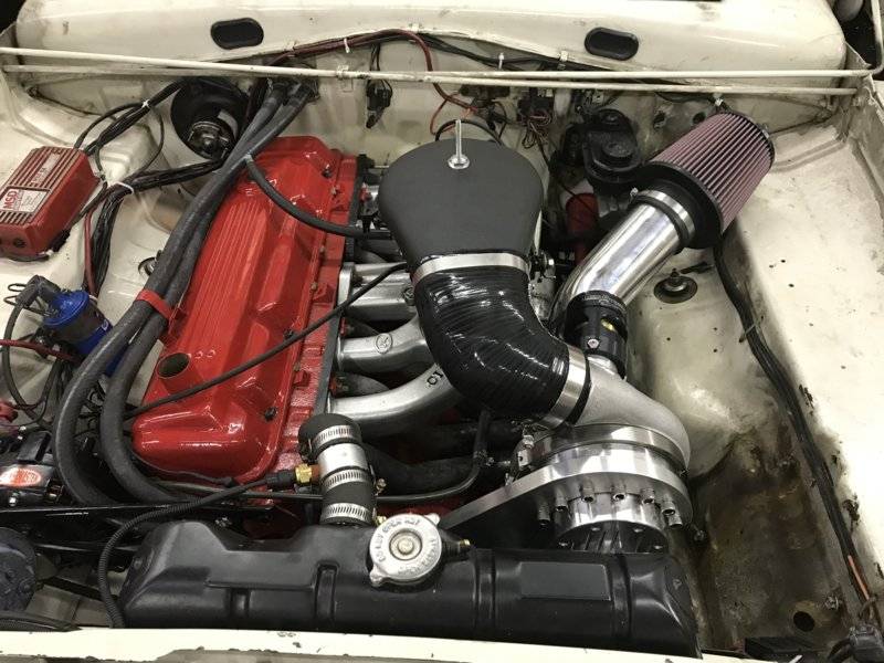

I installed a TorqStorm SC on my 340 Dart and it works great for what I was looking for. Mopar Muscle did a write up in their March issue. At the time of the writing I didn't have any dyno info but finally got around to getting it done. Dyno was around 600hp at the crank at 6.5psi with the original pulley. The complete experience with TorqStorm went vary well. Rick Lewis at TorqStorm was very helpful. I had a March under drive crank pulley that the drive pulley wouldn't match up right with so they had me send both of them to them and they CNC'D a single pulley to work. Great service!

340LuckyMan, that looks great.
Tell us more about your engine combo and add more pics. Especially the blower drive and crank pulley.
James, do you still have your original shorter snout? And what was the length?
I might just do a 10 rib conversion, I need a shorter snout to clear my stock mechanical fan....
