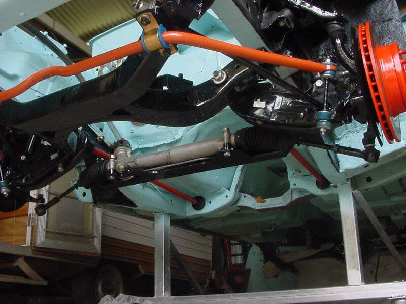

Here in Australia it is very common and works a treat. There are two systems available both behind the K frame.
A rack & pinion is better than a recirculating ball. Make sure you have no bump steer if you get a rack and mount it yourself.
