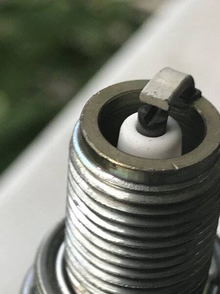

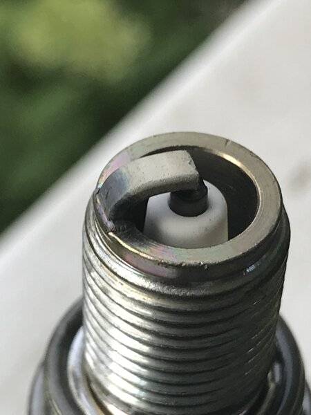

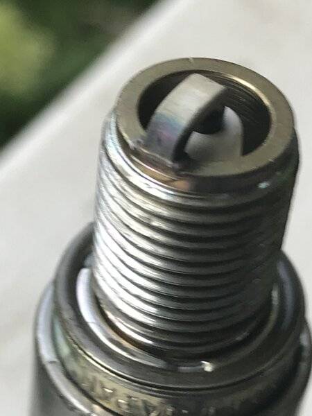

These are my plugs after 2 nitrous passes. How do they look? Ngk #7. 10 to 1 340 alloy heads.
I'm seein like maybe 32 total and 15 or so initial? Center porcelain looks lean.
i don't know much about nitrous plugs but the timing looks perfect and the rest looks good also maybe a tad lean but not sure .do the specks on the porcelain look metallic or is it the pic ?
Specks must be in the pics. Pulled that plug and checked it. Timing is 30 and 22. Thanks for the advise. I’ll richen it up a bit and read them again.
How much N/A induction and how much nitrous are we talking about here? What about enrichment fuel pressure? Got any cam specs?
N/a engine is 350 to 375 is my guess. 100 shot of n2o. Cam is Hughes solid 237 and 242 @.050 lift is .560 and .570 on a 107 Lisa in at 104. Stand alone fuel system for n2o with 110 race fuel. Flowing pressure is 9lbs. Not a nitrous cam but what is in the engine. Speed master heads with correct springs.
