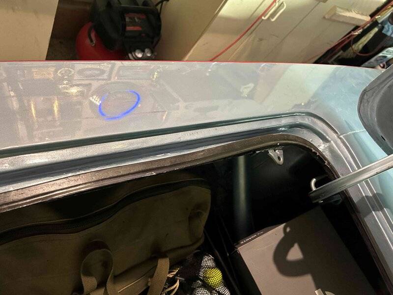

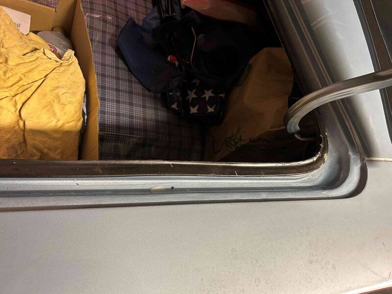

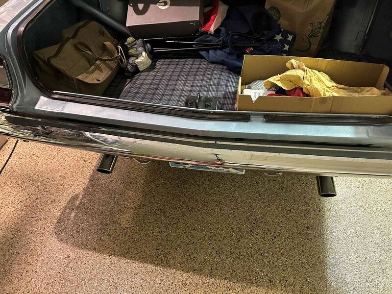

While I was waiting for the last 2 new 14 inch AR wheels to arrive, I cleaned up the rust and peeling in the rain gutter around the trunk seal.
This was my last big project that I had in mind. Turned our pretty clean.
