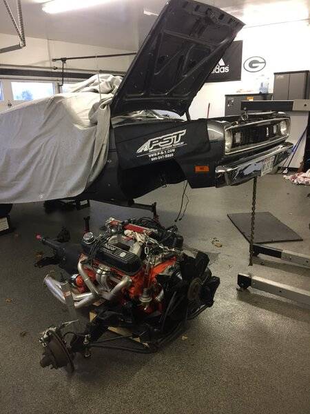

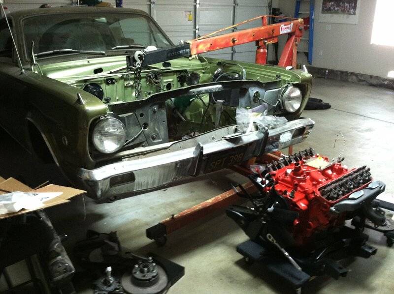

You lower the works down onto a cart or piano dolly. Then use the cherry picker to lift the front end of the car and roll the drivetrain out.
I's allot easier to pull the engine without removing the K-member.
Way faster if you've done it a few times.

Do what works for you, but once you do it from below it’s pretty simple. Even more so reinstalling. Back wheels strapped onto ramps, put some weights on the lift, but front of car is pretty light with nothing up there

I overhauled the front suspension at the same time, so it was a no-brainer for me. Bolted the 4-speed to the engine and bolted to the K-member, put the whole assembly on two cheapie HF wooden dollies, jacked up the front end of the car high enough to roll the assembly under the car, then rolled it under and pulled it up into position to pop in the four big-*** bolts.
