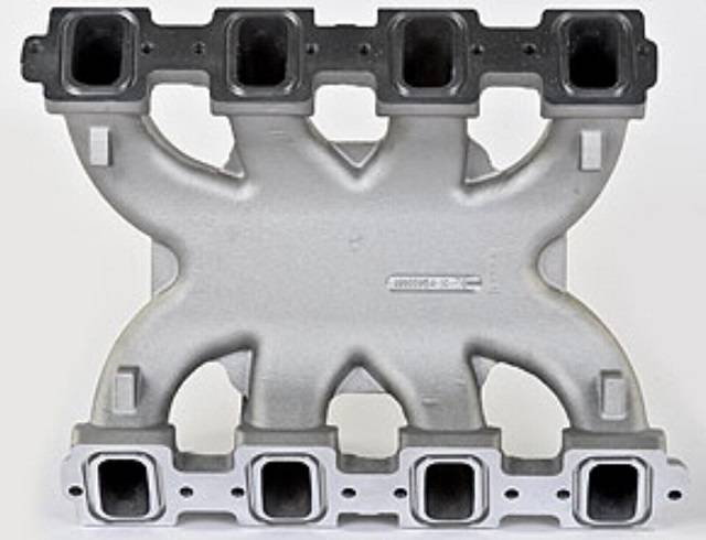

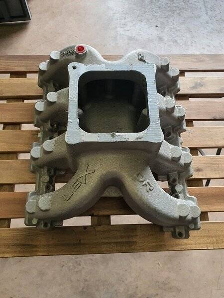

I'm going all LS on my Poly 402ci with this LSX fanimold.

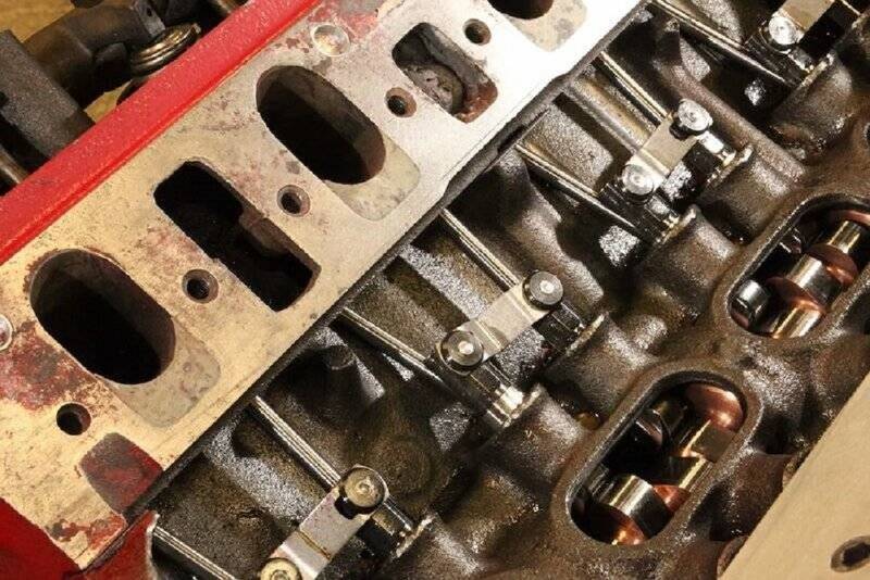

Isn't the small block Edelbrock Victor designed for using a big block rocker arm?
That would seem like it would be the easy button to an offset rocker, but I'm not familiar with how far the stands or mounts would need to move in order to utilize the BBM rocker system.
Here is the note from the instruction sheet in the Edelbrock Victor Small block head, part number 61729. It says "big Block Mopar Wedge" and specifies minimum of .150" intake offset. if these keep showing up in stock maybe we will start to see more guys using them. I wish I had the funds to try them.
Are you going to have to fabricate some adapter plates to fit the manifold to the heads? Are there issues with the manifold width? I know the bore spacings are slightly different.

Yes sandwich plates and lots of machining to both heads and LSX manifold.
Poly manifolds are rare and useless at BEST, so its time for LS stealing... :elmer:
''Why bother'' I hear you all say, we built a Gary Pavlovich 402ci Poly and have no decent intake (as yet).
