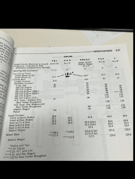

My '75 4 door valiant had standard bias-plys.They quit equipping new cars with bias ply in 75. I figure they rode on new radials and smaller bars for the 75 MY. They probably realized that they needed a bigger bar for radials and came out with the .85 in ‘76.
Is this plausible, @junkyardhero ? I’m hypothesizing the increase in bar sizes correlating to radial use.

anything is possible. the more *likely* scenario is ma mopar trying to save a nickle and doing away with the smaller .830 and just equipping all the slant cars with .850They quit equipping new cars with bias ply in 75. I figure they rode on new radials and smaller bars for the 75 MY. They probably realized that they needed a bigger bar for radials and came out with the .85 in ‘76.
No, they are clean. I must have mixed up the torsion bar and the front sway bar diameter. It's hard getting old.Maybe they're just dirty. lol
front suspension spec page from my 1976 FSM. A bodies are car lines V&Lreally?
do you have a link or a pic of some kind of literature, because that's the first i've ever heard of that. i've parted a grip of 73~76 cars and never seen anything bigger than the standard V8 bars.
Not buying that one. I'm running .88 factory bars and the original 6 leaf Formula S rear springs with Bilstein shocks on the 66. I definitely don't need bigger bars. I have the original .89 on the 68 383 Barracuda, they work also. Neither sets of bars are going into the trash. One size does not fit all.

@Mattax is right, the A’s didn’t come standard with radials. The complete changeover for Mopar was when the F’s replaced the A’s, the F’s got radials standard. And, surprise, they also got a redesigned suspension to go with them to correct the differences between bias ply and radial tire use.

sorry, noThanks, I have wondered what torsion bars were standard on the 76 Police cars that came with factory front and rear sway bars. Does it give the diameter of the front sway bar also?
