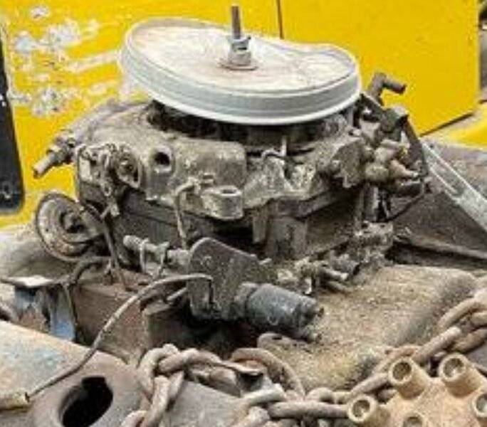

That’s a Carter Thermoquad on that engine not a Holley. The ear Thermoquads were the carbs to have in the early ‘70’s.
yes. thermoquad for sure.
The engine I'm talking about is in the Nick Garage video. It's a Holley.
