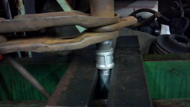

Made a five dollar tool to press LCA bushings in. Hose inside is 3/4 to protect threads and center bushing. Had to grind out half the threads to slip it over the shoulder of the bolt. Pipe is 1". "Hammer" heads could put a cap on the end and pound away.

Nice job. I'll be rebuilding my font end in a few weeks. I think I'll just have to make one of these for myself.

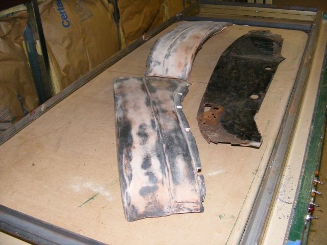

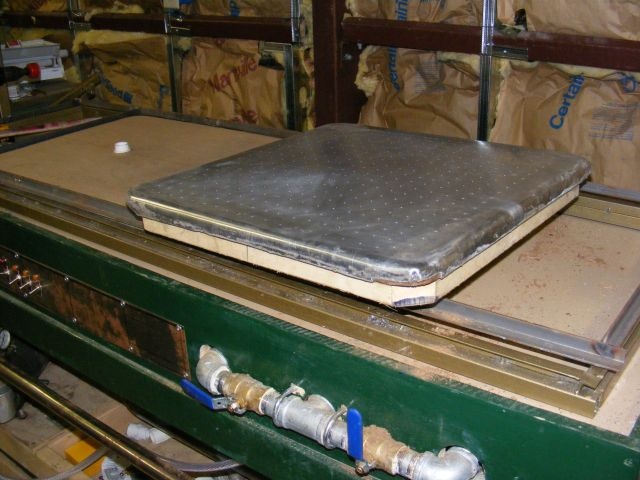

Then they both count since I made em from pieces I had and found online to get the results I wanted. I'm playing with the DIY wooden cnc now. I'm making kick panels molds with speaker pods in them for my early A's and just waiting on the electrician and some aluminum to finish off the vacuformer so I can make the ABS kick panels.
on the vacuformer it's all done except for wiring it to the fusebox and breakers
I have a 2' x 2' platen for small pieces (like the kick panels) "done". the 2' x 4' needs the aluminum plate bent and sealed to the platen so that I can do my rear side panel top plastic piece for my convertible (oh and all 4 splash shields, I'm tired of rotten splash shields) the 2'x 6' (for my convertible top header channel, console and other stuff) is just gonna have to wait on more money(and time!). I built a smaller one years ago and was sorry I sold it. This is the big brother of the small one and I'm keeping it. just think of it as a monster toaster oven.
That's cool! Those Dremel cut off wheels suck though, at least in my experience. They seem to come apart if you look at 'em funny.
hey thanks. and yes wheels hopeless if put any pressure on em but sweet for this. the whole ryobi set up is only good for lite stuff really
