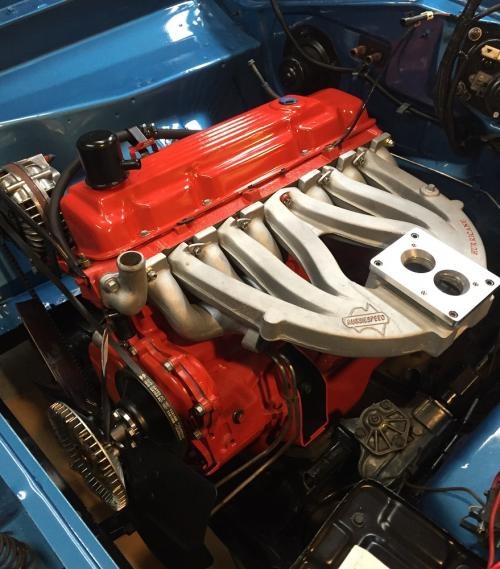

Here's the motor in my son's '69 Dart. Finally getting some miles put on the car, and it's running real nice.
The EFI wiring could use some attention to routing more cleanly; it looks a bit spaghetti-ed under the hood once you hook everything up.
Nice! Not very often do you see those hurricane intakes take use of the bungs, and when you do, its nitrous instead of EFI. Any specs on it?
