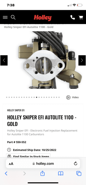

I want to use the Holley efi single barrel kit . They say it's designed to use ford auto lite flange only.
Wondering is there an adapter ? And how different are they ?

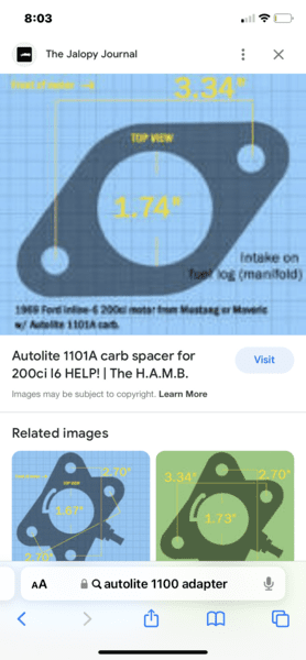

This is dimensions of the auto light 1100 . But I can't find a photo anywhere of what a slants single barrel flange is .

Ok but are they the same as a autolites 1100 single barrels ? Holley said they didn't know . All they said was their little was modeled after a autolite 1100

Holley responded - autolite 1100 is not the same as a slants single barrel flange . They said they aren't sure how much different they are but that they are 100% not the same . Because people ask them all the time if their unit fits other single barrels and they can't . Not without an adapter or making something

1.70 throttle bore and 2.95 bolt hole centers...thank me.

Their claim is that their 1bbl efi kit is for autolite 1100 replacement only. That it was a mainly used only on the ford straight 6s. But. I have their emails to me that I thought about posting it but don't want him to look like a dummy if what he says doesn't turn out to be true . But I don't want to spend 1400$ or more for this kit and it not fit my car.
