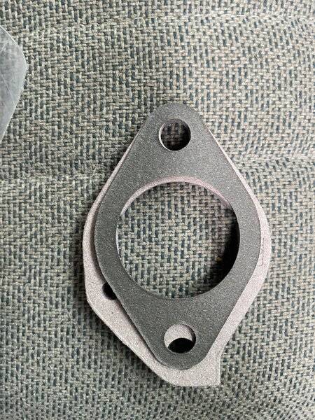

I ordered them yes . Not here yet . We will see. I was asking here if anyone knew the exact dimension of the slant flange because I do know what the exact dimension of the autolite 1100 is . Ford folks have it posted everywhere and yet can't find what our slant is anywhere online including this site . Why dont we / or anyone have this for a slant ? Myself included lol
It's right there. In that top pic, there's your dimensions. Compare that to any 1 bbl gasket for a /6 and there's your answer! Easy as mud.
I gave the dimensions right off a 1bbl intake. Why someone would dimension the bolt holes that are at a 45 degree from each other with a 90 degree dimension is unknown. The slant intake bolts are 2.95" on center probably 3.00" to any 2 bolt gasket. 1.70" bore? Just cut one from some gasket material. For a 2 bolt on carb. Just slot the holes, nothing any of us hotrodders have not already done for Mopars.

My pic is of a ford , I was looking and asking for one for a slant 6 here and all over the internet and couldn't find the dimensions . No one here has them either it seems . Yes I've ordered a gasket for both I've already said that and waiting for them in the mail .

They aren't the same as Holley said.
Top black gasket is the autolite 1100. Bottom one is slant 6 .
I'm not gonna slot the holes in 1400 efi lol . If it was carb I'd round them out or slot the holes but Holley for sure won't warranty it if I cut it up . The gaskets all came and answered the question . The Holley 1bbl which was meant to be exact replacement of the autolite 1100 will not fit a slant 6 stock 1bbl intake

Pretty good bet they are the same/compatible size; see here. If you want to be absolutely certain, buy a flange gasket for an Autolite 1100 and a flange gasket for a(ny) Slant-6 1bbl carb and hold them up side-by-each, as they say in parts of maritime Canada.

They are not the same size .
Just make an adapter then. Holley EFI on top, Holley 1920 on bottom. Use countersunk screws. Probably raise your EFI 1/4 inch. Marine grade plywood, Delrin, Aluminum plate.
