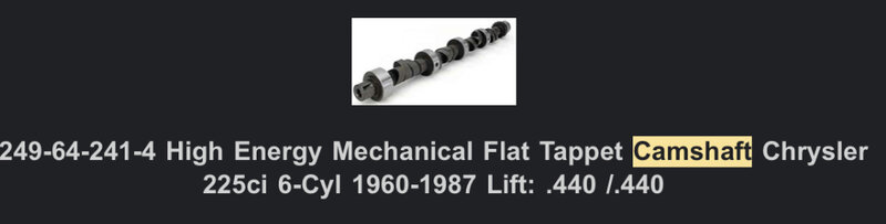

Ok, so a stock cam. You can run most any carburetor.
Rusty, that is mean. :)
Best stock cam was the 71-77 cam.
244 Dur, 26deg overlap, .406 Lift I and .414 Lift E.
Now I agree, it's not a radical cam, but lift is better at .440.
But I have been told I run a street cam in my engine, so what do I know.

Nothing. You're still stuck with the really fat primary side. Why on earth would you want to try and tune it if it's going to be temporary? I'd just sell it to fund something else.
I don't like any of the Comp stuff for the slant 6. It all sucks and especially right now when Comp seems to have a plethora of cam and lifter failures. I'd take that highest lift stock cam any day over a Comp if I was going mild. Comp is done, IMO. I know I'll never use their cams and lifters again. Not me, brother.
