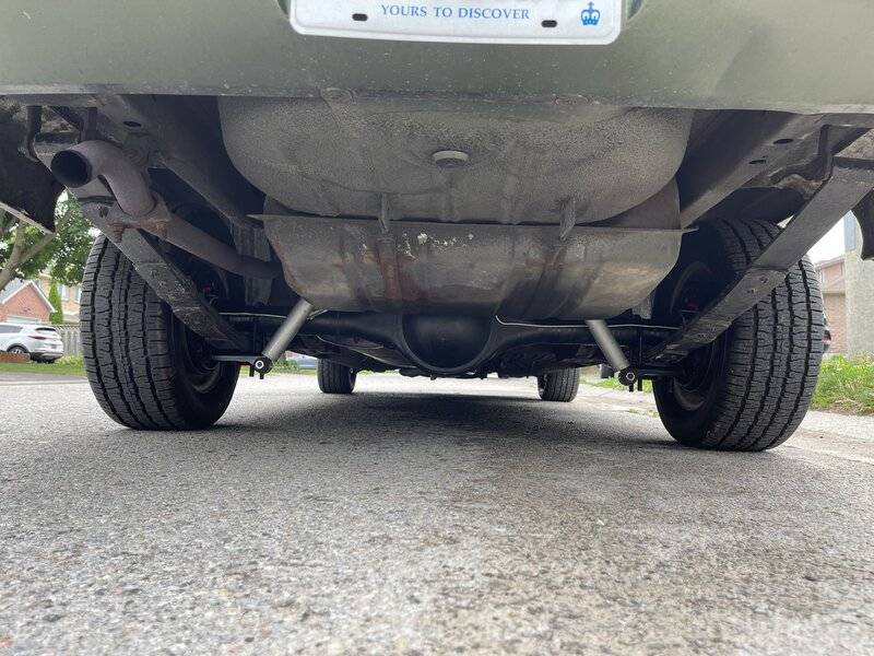

Got the car back today. Everything went great. So the car is setup for some horsepower. New tires all around. What a difference in ride now. When it goes in for paint I’ll enquire about a mini tub and some frame connectors but that’s down the road. But for now we cruise and sort out my engine build problems.

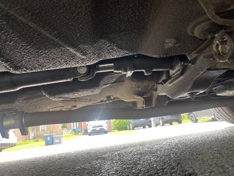

Well that explains it. I sent a spare shaft down to the shop. The shaft was for a 727 8.75. So it’s obviously two short and they used it. So this would explain the racket underneath at speed. So I’ll take the car over to them again next week and use the “roll on lift” and do a remeasure and have the original 904 7.25 shaft cut and balanced. We learning folks.
Ok a little better but noise persists. I only had it up to 70kph and it started. I didn’t have time to take it on the highway yet. Try that Monday. Brand new shaft as they messed up my slant shaft. They cut the wrong end off and it had the rubber sleeve in it and I guess they didn’t want to deal with it. So all new rear, u-joints and shaft and we still have something going on. To what extent we find out Monday with a trip up to 100Kph. Not going to mess with it as Moparfest is this coming weekend. It’s good enough to get me there and back.
that looks better, i'd still have made it longer though. if there was a normal seal and not the one with the long dust 'cover' bit it'd be clearer. looks like there's a polished mark on the yoke where it used to be further in and the seal touched/rubbed on it, but that's not even in the dust cover. it'll be better yes, but not ideal.
neil.
She was marking her territory pretty good before. It stopped now that we pulled it out a bit. It was a decent grove where the seal rode. I agree it’s a bit two short still. 51 3/4 is what we have centre to centre ( /6 - 904 - 8 3/4 ) This shaft will be cut down again once we get the 440/727 in there.

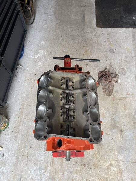

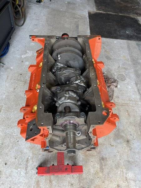

1971 block acquired, cleaned and all the goodies done to it. Bored to .030 over. Crank, pistons fitted. 10 in the hole
Cam installed. ARP head bolts grabbed from Mancini’s at Carlisle.
