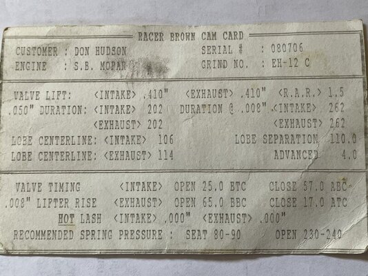

We discussed my 273 and my 65 Dart build and he did this one for me. Nothing fancy just a bit more than stock. Got it in the block which is as far as I’ve got
if both cam & lifters came from Racer Brown ballpark likely 4ish . Very happy with what he did for us. His ST-14 cam and Johnson solid lifters.
