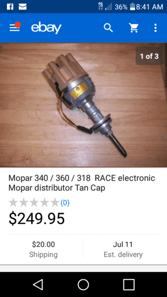

Yes - Pretty much all Chrysler distributors worked that way. That includes the Race units (aka tach drive, no vac advance) but for those, it was super fast in, then super long slow - almost like locked, but better. I drove thousands of miles with one, and as great as it was at the track, I can also say its not the best setup for street.
The primary and secondary curves can be started sooner or later by adjusting the spring perches. That much can be done without disassembly. Changing slope requires changing springs.

Sunland CA
Let me know if u need one and I get u his number I have purchased 4 of his units for RB engines and now my LA project .
Here is one on Flea Bay he is selling go online and save it to your watch list he is Rock solid guy .

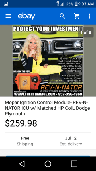

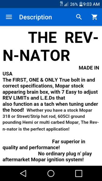

Factory unit with good coil and this unit with a built in adjustable rev-limiter should get the job done !!!
Amen !
On the other hand I believe that Revelator is also a bit of a gimmick. The one that I had bolted to the firewall from the factory was just as good as anyting aftermarket. My personal rev limiter is my valve springs.
I like your way of thinking !!!
