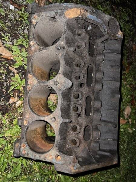

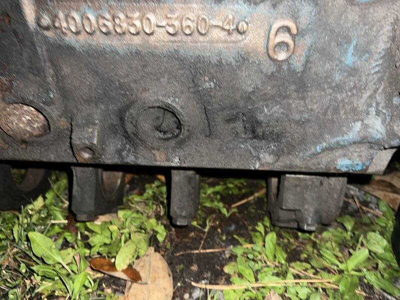

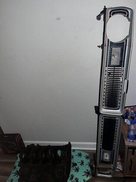

Alright I have picked up the block. Went with a 360 block with a pair of stock 360 heads that will be ported. I’m just gonna go with the 418 stroker kit with the comp cam and send it with the advice of a mopar machine shop nearby. Also picked up this grill today at Carlisle for 225$ the dart custom. I know I’m wrong but it looks so much better than the other grill.
Good deal... and I did the same thing with My '72 Swinger, swapped to the earlier grille, don't toss Yours tho'!!! Lots of '72 Demon folks looking to resto will want it..
I’ll text him. I’m needing standard work just a bore for the stroker kit and a port on the heads. Then advice to build it.
Any machinist will need the piston to properly set it up for best results.
Is your assembly in hand? Is it balanced?
