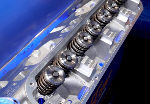

Suggestions for new design Aluminum Mopar SB clean slate (kind of) cylinder heads

So what is the highest flow volume on a SBM design? No particular head, what is the king of the hill, ported not puttied SBM head? Let’s get it there and move forward. Isn’t that a good start?

Take a look at the trickflows especially the rocker shaft mounts. They are much more beefy than the stock heads.
They also work on la and magnum blocks
Symmetrical ports (ala SB2 NASCAR motor)? Maybe with an LS intake or something?
Direct injection?

Thank you all for the suggestions. All are appreciated. Please remember goal here is gain some performance while providing you with economically sensible crate engines. It's not to design a 9000 RPM, 900 HP, SB with 13:1 compression that would cost 16K, and we'd sell 5 a year of. If someone wants 800+ HP...we sell Gen III's. Gotta Draw the line somewhere. Some may call it weak, I call it practical. I will note the set here flowing 290 are ported. We'll probably use an as cast version on the current alum head 408, and maybe do a ported set on a bigger one. time will tell. I'm really excited about it. Glad to see the interest!
A 2.08 valve won’t clear some pistons I’m told and is totally unnecessary in a 290 cfm head. A 2.02 with do it and a 2.055 does it easily
Hi PBR. Don't you think the head should be capable of handling a 2.08 intake valve? I remember you commenting a Trick Flow can't accommodate a 2.08. Someone porting this new head might want that 2.08. Just thinking...

It’s not my head. Lol. But yes a head seat should be big enough for a 2.08 valve as some of us like to do stuff like that. I was just throwing some suggestions out there.

Mainly I don't want to add $1500 to the price of our already expensive engine when we can design a head ourselves and remove cost vs today's price. Also relying on an outside manufacture to supply 1000 heads a year is asking for disaster. From what I hear the supply chain on those is super slow.

Good point! If the valve cover rails were a smidge taller, we also wouldn't have to notch our valve covers to gain manifold clearance.

Trouble is nothing is as simple as it appears. Did you ever notice pushrod notches in the valve cover pan rails. I have and you should see what I have to do to the spacers to even get them to work. I notch the heck out of them. Most guys wouldn’t want to carve on a nice head the way I have to do to those spacers.
