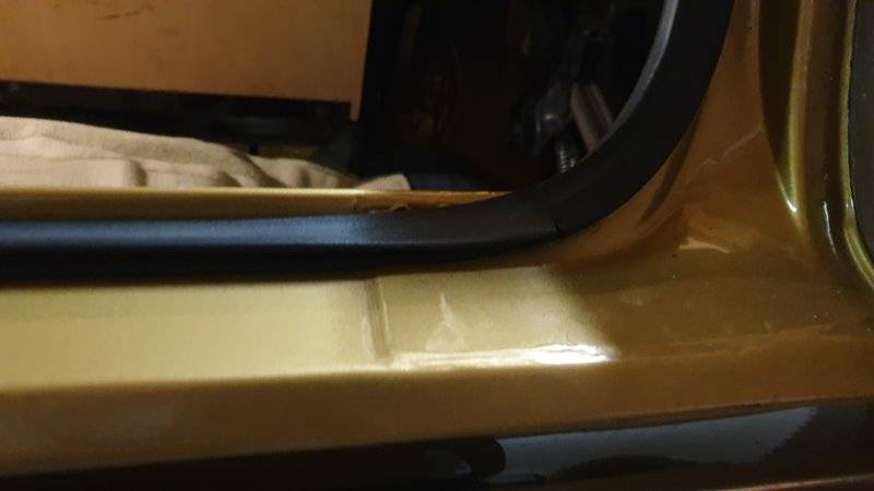

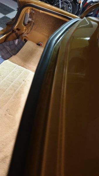

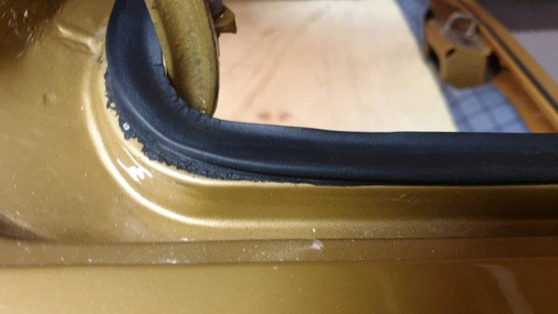

Hoping someone can help me with this one. Since installing the new trunk rubber strip on my Cuda, I am unable to get the lid to align properly. I noticed the problem initially when I reassembled the car but wrote it off to the rubber being new and thought it would compress after a while. The bottom edge of the trunk lid sticks out about 1/4 " and therefore does not align properly with the taillights. I have seen other Cudas on here with the same problem so just wondering how you adjusted for this issue. The only adjustments I can see are the hinge bolts. Is there any adjustment where the hinge bolts to the body?
Funny thing is that the lid fit fine before I painted the car with a new trunk rubber seal that I had installed previously.
Are you sure the strip is in the correct place and direction. I have so many wrong positioned rubbers, installed from pros!
IIRC I stopped my strip bottom of taillights possibly for same issue. But I will check.

Hi Andrew
If everything is correct, try to adjust the trunk lid and give more preload. It takes some time to set down the new rubbers.
Or try another brand, some replicas have the wrong shore and you will never be able to proper adjust the trunk lid.

You may be on to something there with the brand I used. Ill post pics tomorrow
