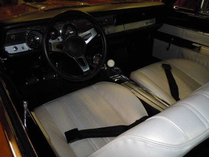

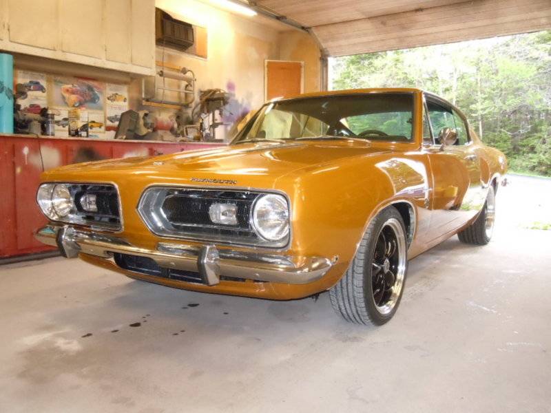

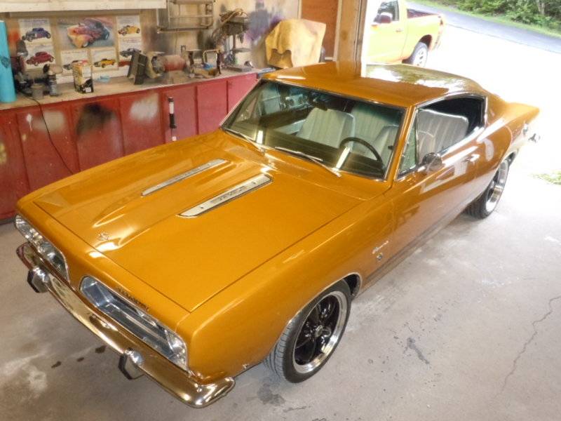

Well.. here I am in the dead of winter in this part of Canada so time to address some of the issues I have to deal with . Tach not reading properly, oil gauge reading too low, gas gauge all over the place, definitely not accurate sooo ... sending the whole cluster out to be completely checked over and recalibrated. Before/after pics to follow...
Finally !!!

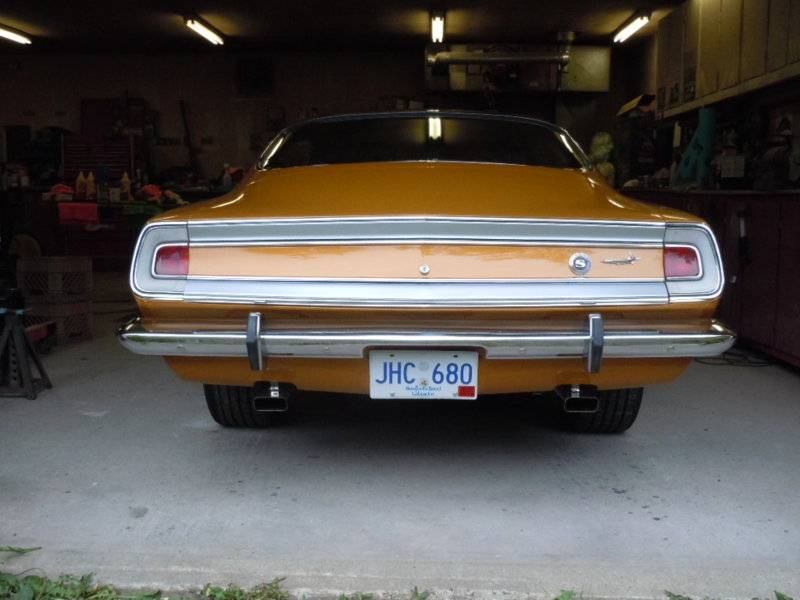

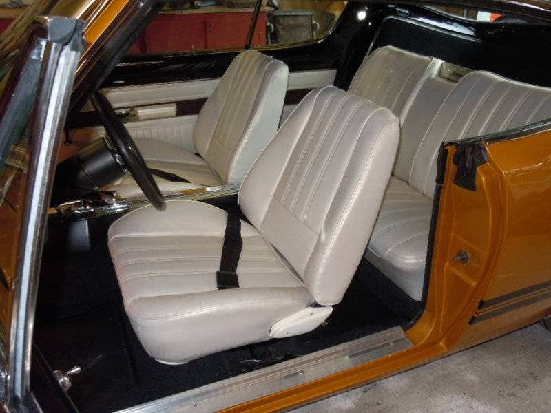

Supercuda is finished!!
Had the car out last night for the first run and it went flawless !! Extremely responsive engine and the RMS suspension with the rack and pinion steering makes for an unbelievable ride!. What a difference between the old torsion bars and manual drum brakes... totally blown away!! Also the addition of the 4-speed from the auto trans is just magic.
Here's some pics of ole Supercuda just before leaving the "Stable" for the last time. Go Pro video to follow...
View attachment 1715192683 View attachment 1715192684 View attachment 1715192683 View attachment 1715192684 View attachment 1715192686 View attachment 1715192687 View attachment 1715192688 View attachment 1715192689 View attachment 1715192690 View attachment 1715192691
Very nice, mine has same interior and color.
Awesome build! Love seeing the finish product come out this great.
Thanks WRB426 !! Long expensive road to the finish but I'm loving the car. Got some great help, ideas and support from this site!! Now... only 3 months until I can drive it again!!
