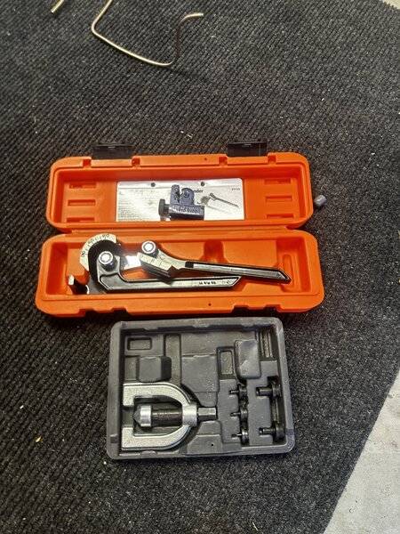

I’m trying to decide if I want to use the tools I have (cheap flaring tool) or if I want to buy the good one.

My son bought that high dollar Eastwood flaring tool for his project car and left it at my house. Recently I needed to flare a custom brake line. That Eastwood tool made flaring so much easier.
If it was me, I'd pony up for a good one. I tried using a HF special, it sortakinda worked, but it was not inspiring of confidence. My buddy is a pro mechanic and loaned me one from MAC, it is a huge improvement. If you only need it a little bit you can sell the good one later to get most of your investment back.
there are good double flare tools like the one from eastwood and a little cheaper - shop around - I buy tubing from autozone and make my own lines - what works is patience and also using a piece of hard wire to make a mockup of what you are trying to do - also get a bender for 3/16" tubing - their out there you just have to look
I have never had the good tool, and like said, the cheap one is BAD for an unskilled flare guy like myself!!!!! I can't always buy the pre bent stuff and when I can't, this old man just cries!!! At your age Doc, I would buy the good tool and practice for what it takes. Good tools last a lifetime!
Buy the correct tool. Be done with it. Redoing it 3 or 4 times is not saving you money with a cheap tool.

Flaring ends takes practice. I have had a Snap On flare kit for years that does a good job if I pay attention to every step and detail of the flare. I use it so infrequently that I practice on scrap tubing every time I need to use it, before I get down to the "make or break" point. With mine, it is critical to have the bar perfectly aligned and the tubing exactly as far through the bar as it should be, and no more, before pushing the first bubble on a double flare. After that is done correctly, the second part of the flare is cake. I had to use it a few weeks ago to make some single flares on 3/8 copper for compression flare on air lines when I added an after cooler to my new compressor. Took some practice for sure on that stuff!
