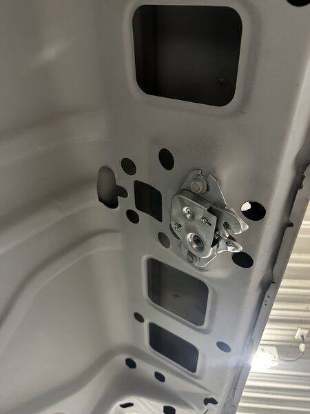

Stole hood and trunk latches off of the black car as I didn’t want to look to hard for any in my bins.
Cleaned the old paint off of them and installed them on the car.
Trying to think of what else should be “installed” or on the car when it gets painted.

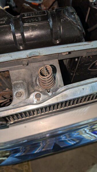

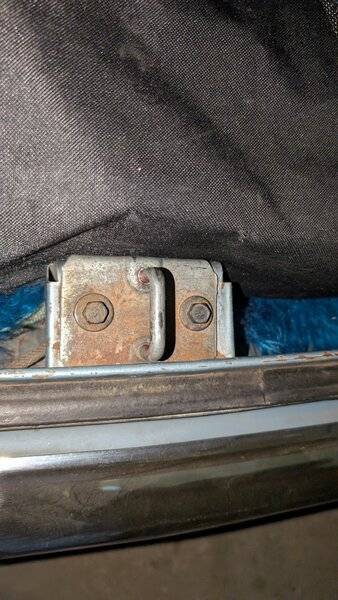

Some items that don't have body paint on them in my 67.
The hood latch on the hood has some color but I think it's over spray from 2 past bad repaints. Nothing on the back side of it.
The safety latch I think was black at one time.
The rest galvanized color.
Basically if it's rust colored no paint.
View attachment 1716379166View attachment 1716379167View attachment 1716379168View attachment 1716379169
This helps a ton.
I have seen many catches painted, body color but not the latches. I would think all the catches were also raw, galvanized, off the line. Most repaints are get-it-in and get-it-out, so the catches were painted. I like the comment, "if it is rusty, it was not painted".

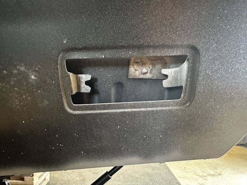

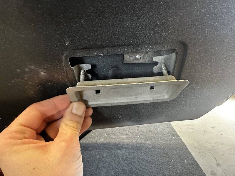

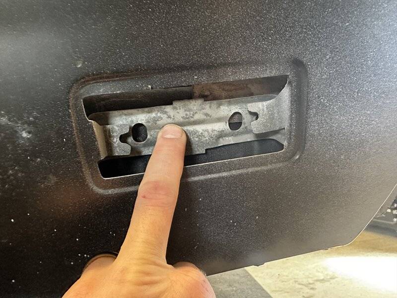

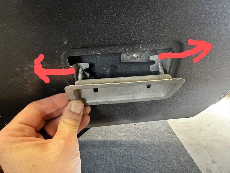

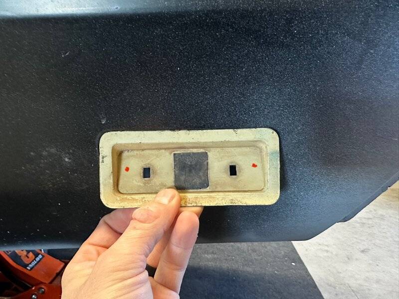

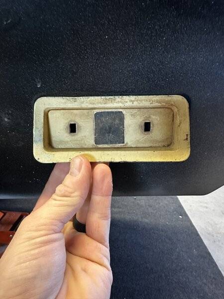

I’m going to have to figure out how to attach these rear marker lights. The rear AMD quarters aren’t the same as the stock quarters.
looks like just drill new holes in the amd panel to suit the markers.
neil.
That’s what I was thinking but I hate drilling holes if they aren’t needed.

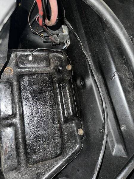

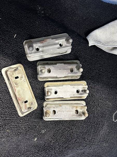

Almost thought I was going to have to drill holes for the battery tray, but apparently there are like 4 different ways these things were attached.
Copper car vs purple car mounting
Bezel is in the correct way, I only know this because it says “top” with an arrow on the back of it :lol:
What I am suggesting is to turn the bezel inside out and check to see if the bezel fits the recess in the 1/4 panel. The mounting holes can be adjusted.

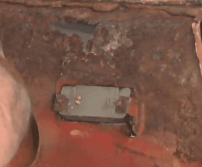

Bezels are the correct size and fit in the location perfectly. Here is how one person did it, but it was like 10 years ago, he hasn’t replied yet.
you only need to drill those tabs so if you want to use the markers then new holes are definately needed.
neil.
That’s what it seems like
No need to drill. A small set of visegrips or channel locks and push those slots into position.
I’m not totally sure what you mean?
Bend the tabs, keep them on the same plane with the plyers. Hard to exlpain I guess, I could to it in about 5 seconds.
I think he's saying using a pair of Tyler's bend (or push) the tabs left and right....keeping them the same distance front to back so the screws line up with the slots.
If I did this then I’d need to weld the brackets to the body to get it to mount like factory right?
I think like the person did in the thread from 2016; if I cut the studs off and then drill small holes 1/4 or M8-M10 and attach some
Captive nuts there and screw it all together it would work. Maybe I should see how far in the lens go to make sure I don’t hit the screws.

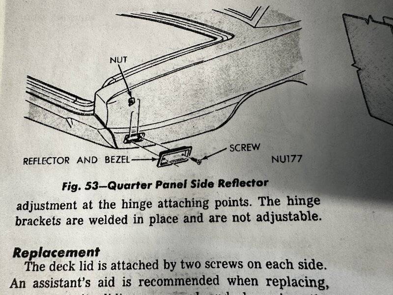

I'm a bit confused...
The factory does not seem to have the backup plates that clamp the housing to the quarter.
It also looks like the tabs could be bent to fit into the correct positions.
