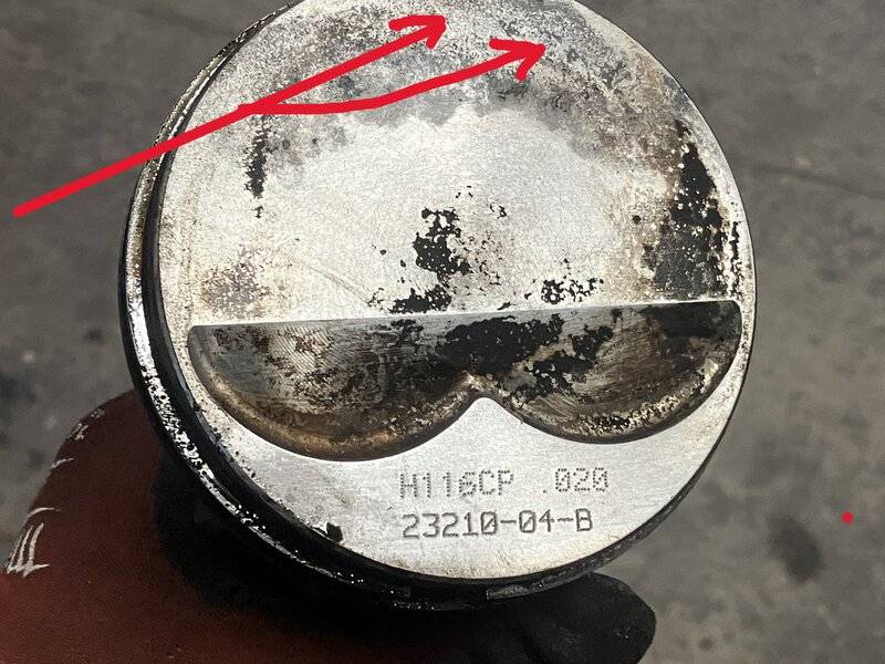

Those are what was in this engine:
Yeah, that's the weak spot in SB head gaskets,... and where they fail when there's excess pressure/detonation/pre-ignition....
What do the piston crowns look like? That's a systemic problem there, big time.....lean condition, high temps, timing way off, crap octane.....combo..

The piston deck oppo the stamped one shows detonation alley, that's what it looks like, & that's what's killing the gaskets. You're makin' the right call on the new piston choice, You can work the tune & avoid it, but You'll be able to make plenty of oats w/less squeeze/headaches.
Do you mean right here?
I didn't rub my fingers on that but you may be right if you think detonation was occurring there. I'm not sure though. The piston is upside down in this picture. Water sat in a few cylinders so that could be stains from that.
Yes, & the the upper-left @~10:30 looks like the edge of the crown is erroded, hypers are a little tougher so the pitting isn't as deep as plain cast'd show.
I just went out to look at a few of the pistons. What I saw was discoloration but I can’t feel any pitting. I’m not dismissing the possibility of detonation damage, I’ll need to look closer. Water did sit in a few cylinders so at some point, aluminum stuff tends to change color and texture as a result. This engine had been sitting for 2-3 years (covered) in a region that gets light snow so I expected some cleanup would be part of the deal.

May be cell-phone photo illusion, making it look that way, but........
