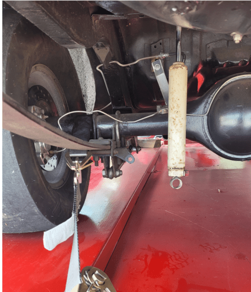

Pulled the RH rear shock. Pretty obvious why there was an issue with the left one. As suspected, the bushing was just crumbled!
The fix? New Calverts, of course!!
