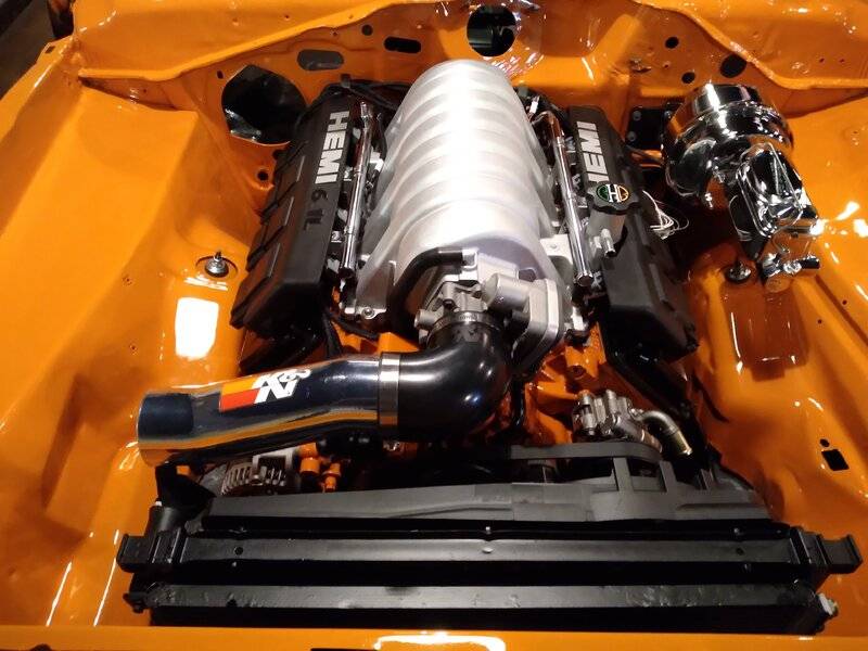

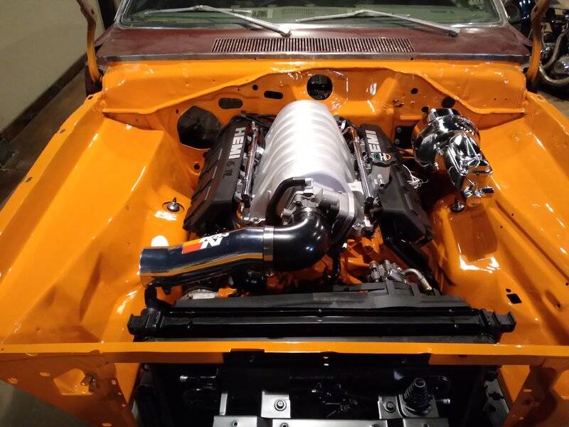

So still waiting on my summit parts but but did get the radiator set in and the air inlet tube on. Now I need to build a front cover to hold the top of radiator in place,as well as give me a place to mount overflow tank,and power steering reservoir.

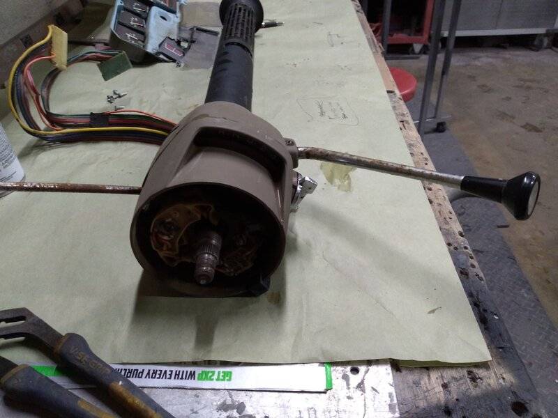

These are pics of old column for DusterDaddy
