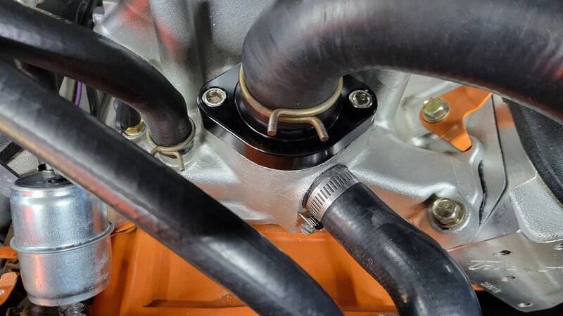

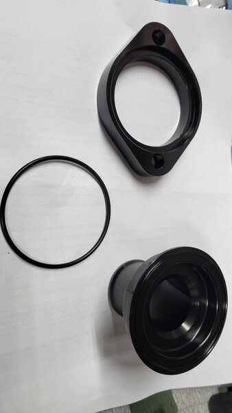

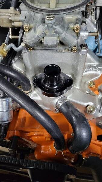

Years ago I tried a bunch of different gaskets and tried sanding both the surface of the intake and the thermostat housing cover and it would always leak. I then bought a Billit housing with the o-ring gasket and it’s not leaked since.
Get a Flashpower #181491-200. O-ringed housing. This is for the large thermostat. When torquing, we are talking inch lbs, not Foot lbs, 15- 25. Had your same problem, not a anymore.

so if i get the O-ring style do i still need this?
probably not.. but if you use that you won't need the o-ring style... the aviation sealer is more a shelac that brushes on, a very thin layer and it 100% will not leak..
No sealer on the o-ringed housing. You may want to run a file or sanding block over thermostat base on the intake, just to be sure that it is flat.
