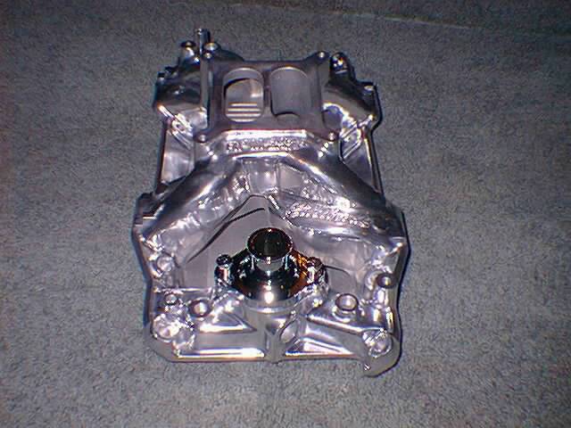

I had the same problem when I installed an Edelbrock Air Gap and a chrome thermostat housing. No matter what I did, it leaked. Then I bought a Billet Specialties polished aluminum part with an O ring. Hasn't leaked a drop in years.

Smooth surfaces like chrome are difficult to seal, no matter what you use. If you use chrome, use coarse sandpaper & sand off the chrome to leave a rough surface.
Using a Dremel with a small carbide tip, I ground a small channel into the gasket surface, on the intake flange & t/stat housing. About 0.020" deep, not critical. This provides an 'anchor' for the silicon.

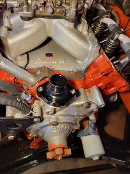

Get a Flashpower #181491-200. O-ringed housing. This is for the large thermostat. When torquing, we are talking inch lbs, not Foot lbs, 15- 25. Had your same problem, not a anymore.
I’m having the same issue on my Duster that I just got. Chrome housing just leaks. Reading through this thread, looks like this one is the way to go. Any recommendations on thermostats? I’m not sure what’s in it now, so I figured I’d just replace it.
Also any recommendations for an upper radiator hose and intake bypass hose? Need to replace those as well.

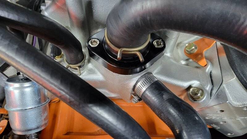

You can get your hoses at any auto store. I used Robert Shaw for the thermostat, the large one, not the small one. 180 or 195 for temp, I have used both. Correct length allen bolts come with that housing, 15-25 in lbs for torque. No sealer.
