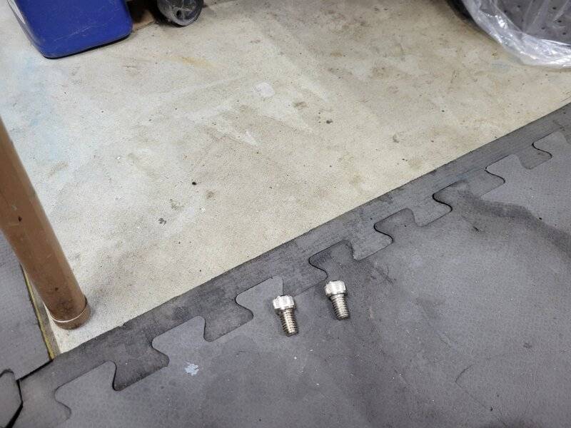

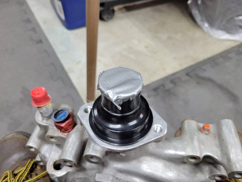

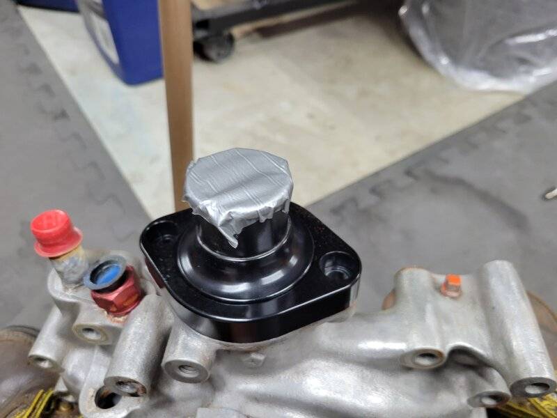

Finally got around to installing the Billet housing and it’s still leaking! I was refilling the radiator and noticed coolant pooling in the exact same spot as before. Frustrating!
Are the bolts bottoming out? Are the surfaces flat? Check the obvious first.
I actually had to get a bunch of gunk out of the bolt holes because the first time I installed it, it wasn’t flush. But once I did that, everything went on smoothly and laid flat. If the thermostat is off center, would that cause issues?
Can you post a photo? It shouldn't move much the the bolts partially threaded, but I've never had one of those fancy billet pieces. I guess I've just been lucky with all of the stock housings I've installed.
If you install the bolts without the thermostat housing in place they should go all the way in or nearly so.
If the distance between the bottom of the bolt head and the manifold with just the bolt installed is ( just numbers for example) 1/4" and the thermostat housing is 3/8" thick then the bolt bottoming is not the problem.

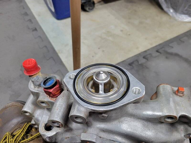

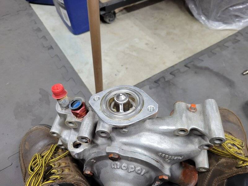

For antifreeze to leak out when just refilling, it would have such a massive crack that it would be visible. Just took the housing off my Hemi water pump housing. This is pretty simple, even for me. Thermostat, o-ring, housing fits into the o-ring perfectly, housing has a recess for thermostat, install the clamp housing and torque to 15-20 inch lbs. This housing is very simple. Believe you have something else going on. Take a closer look at everything.
Ok I can confirm that it was user error haha. I took everything apart and the thermostat was crooked inside the housing, so assuming the housing couldn’t seat correctly. Used a shoe string to hold the thermostat in place and tight while installing the housing and now all is well (knock on wood.) Got it heated up to operating temps and all looked good.
