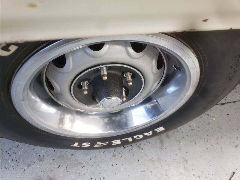

I also decided that I really want to run the Rallyes that I bought. So I did some washer stacking and found that if I run 1/2" spacer, they'll clear the caliper. So I ordered a pair of hubcentric/lugcentric 1/2" spacers and ARP extended studs. I really didn't want to go that route but it is what it is. I'll just be sure to constantly check them.

Getting close.. Motor is back together and Arp wheel studs done on 1 side (only 1/2 my order came in) and the wheels fit great with 1/2" spacer...i just need to decide on optimum tire size for the 6.5 wheel.. Plenty of room. The other 5 arp studs should be here today.
