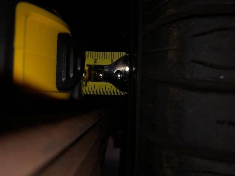

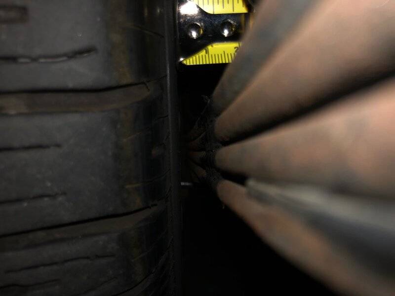

The pictures aren’t great but the gap is about 3/8” on the closer side.
