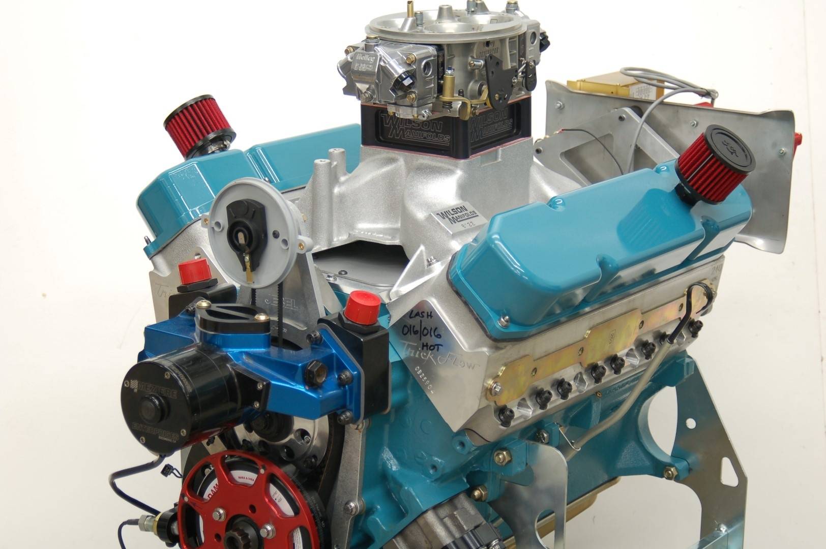

Swapping on a ported M1 4500 intake with a 1050 Dominator picked the power up to 715 hp @ 6500 rpm.

Wilson did a huge amount of work on the M1 intake. They added about 1/4 inch of welded material on the outside of the runners and then opened up the runners a large amount. I think they increased the runner size by about 25% which is a very big deal. They basically created a new intake manifold from the one that I sent them.
The new Trick Flow intake is very nice, but it isn't nearly as big internally as the Wilson modified intake. So I'm not surprised at the power difference between them. I could've run a Dominator on the Trick Flow intake to see how it worked but I didn't have an adapter with me. I suppose a Dominator on the Trick Flow would get close to the Wilson intake. Probably get over the 700 mark anyway.

I always use a tapered spacer under the carb. I've given up even trying open spacers or four hole spacers. I used a 2 inch tapered spacer from Wilson under the Dominator and a 1 inch tapered spacer from Trick Flow under the 4150 carb.

Porting the intake is usually worth 20 to 30 hp on a race type engine. Most guys don't get their intakes ported since it is expensive, but the cast intakes leave a lot of power on the table. For a retail customer Wilson would charge about $1400 to do the porting that they did on my M1 intake. Most bracket guys aren't going to spend that kind of money on the intake manifold.

Depends on what you're doing with the engine. If it is a drag race car and you want the most power out of it then i'd go with the M1 4500 intake and a Dominator carb. Any sort of street driving or street/strip type of use I'd gladly give up the few hp and run the TF intake with a 4150 carb.
Good question on the ported intake. Mopar Performance just made this intake too small for an engine like mine. They must have designed it for a stock 400 engine. Some of the aftermarket intakes are made bigger. For example, Indy did a 440-3X intake which is designed for 572 engines. But yeah, most of the time the intakes are made way smaller than they need to be for higher power combos.

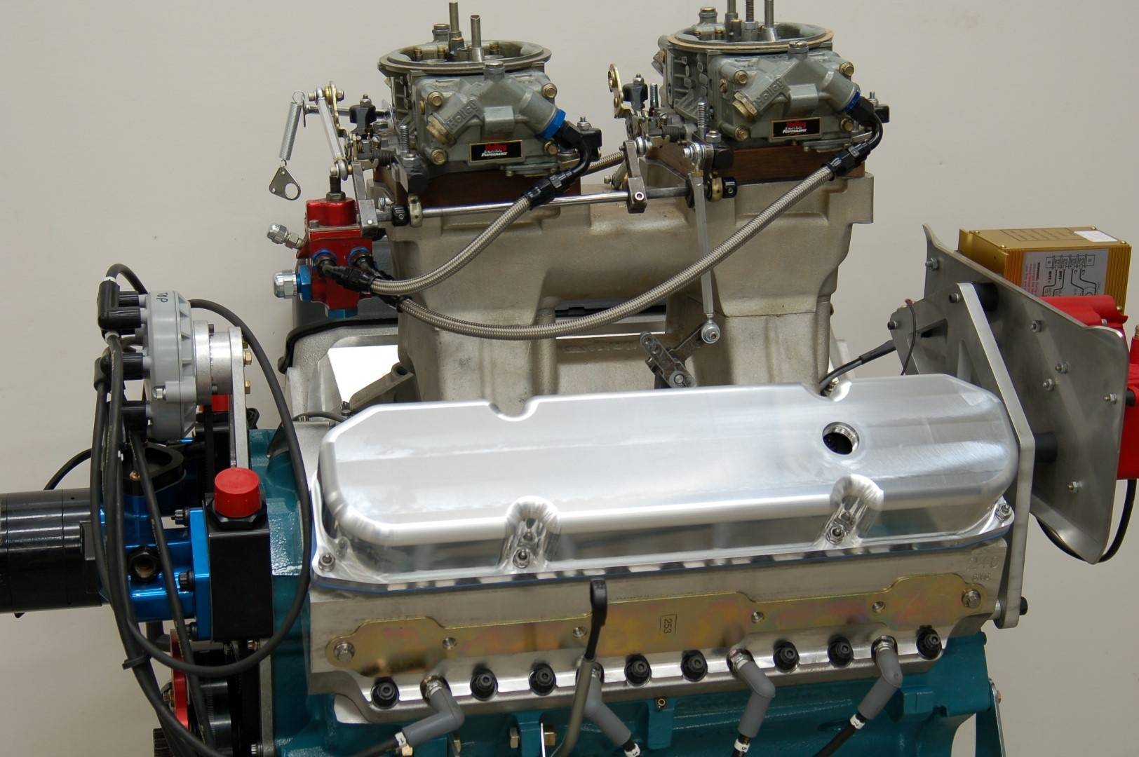

I'm going to try a tunnel ram next time I get this engine on the dyno. We'll see how far these Trick Flow heads can go right out of the box.

New picture with the billet valve covers. Next step is to pull a cylinder head and ship it to T&D to get some rocker arms made.
