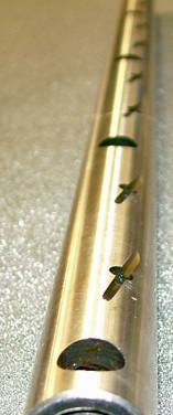

What about these shafts with banana grooves? Better oiling?

A banana groove on the shaft and a full length bush is the way to go.

Personally I'd be adding an oil groove to the shaft.
