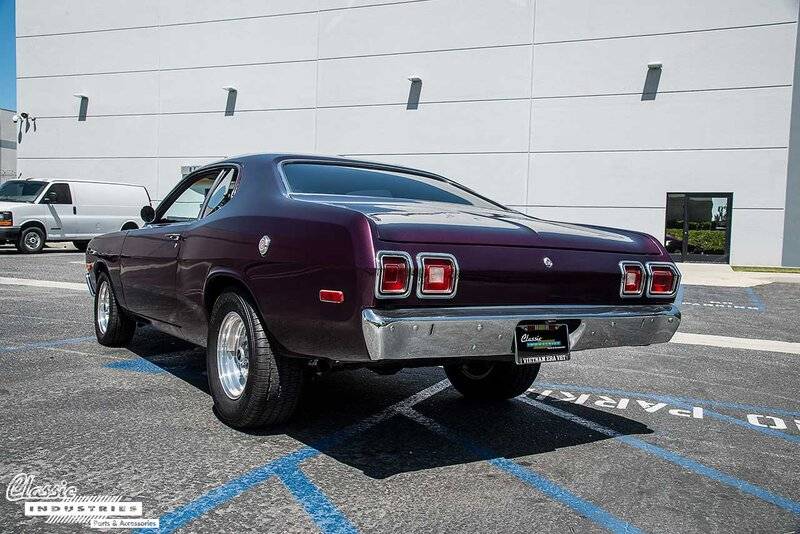

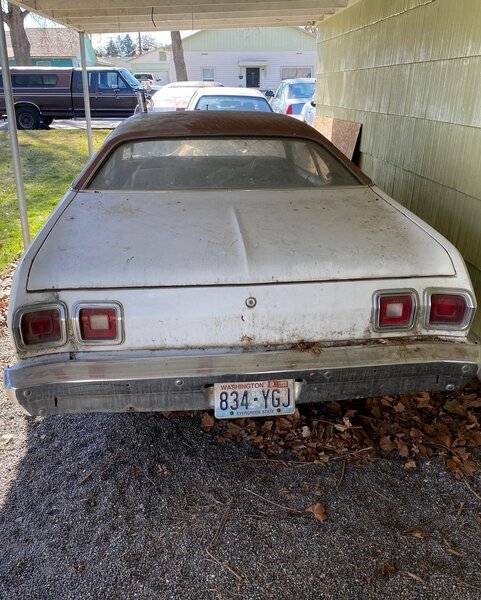

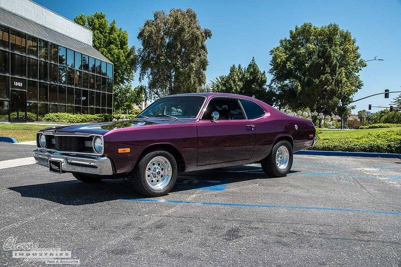

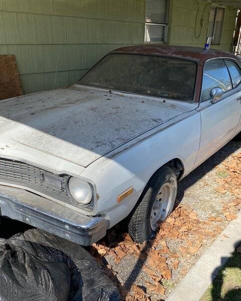

One day I hope to be one of you guys that can have an engine swap done and have it running again in 2 hours lol. One day. Once I have the drivetrain where I want it I’ll get the metal work and painting done and restore it. I got big dreams for that car. Here’s some pictures of it in the white, and the purple one is what I want it to look like, plus a full canopy white vinyl top! Probably also the white stripe decals down the sides. I think that will look cool. I’ll keep the black interior though, since it’ll still look good and won’t show dirt as easily lol.
