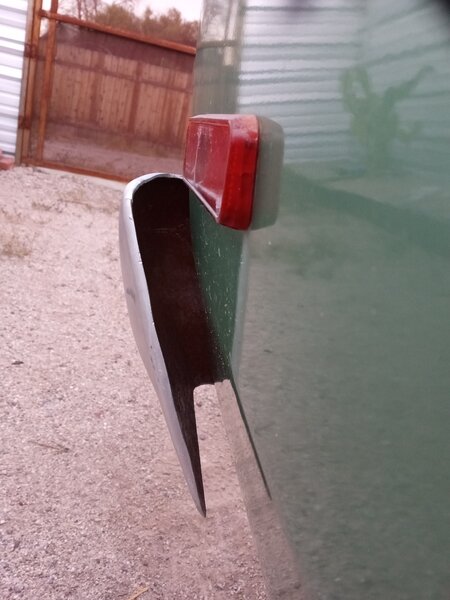

Conversion brackets won't fix it. You're at the point where you have to cut fiberglass, and rebond the end back on. Be sure to wear a respirator when you cut the fiberglass.
Yup, that's the problem with the '74+ rear bumpers. They're wider than the back of the car, and they don't look right tucked in.

With either method, you will end up with a gap between the body and the bumper. The '70-'73 cars had a flange on the tail panel that covered this gap.

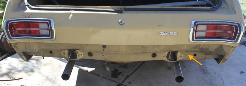

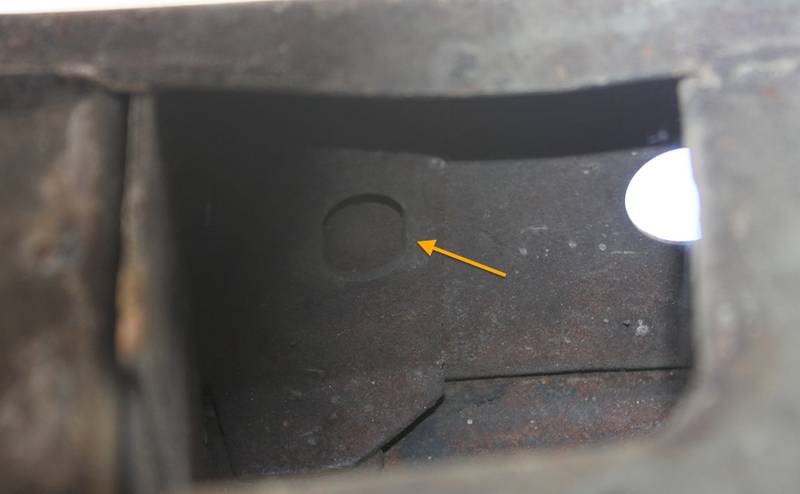

The frame rail already should have the bracket behind the panel with the hole in it to locate one of the bracket bolts, you just have to drill it out. The tooling for the axle stub wasn't changed from the earlier style. From the outside it's here
And from the backside it looks like this
Then you just need something to go between the earlier bracket and the later shock mount bumper bracket hole, which is what I did with the angle stock. Although yeah, if I had to do it again I'd just get a piece of 1/4" or 3/16" flat stock and bend a 90° on it in a vise. Way easier than what I did, but I didn't have the flat stock and I did have the angle stock so that's what I used.
