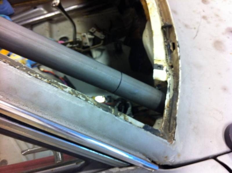

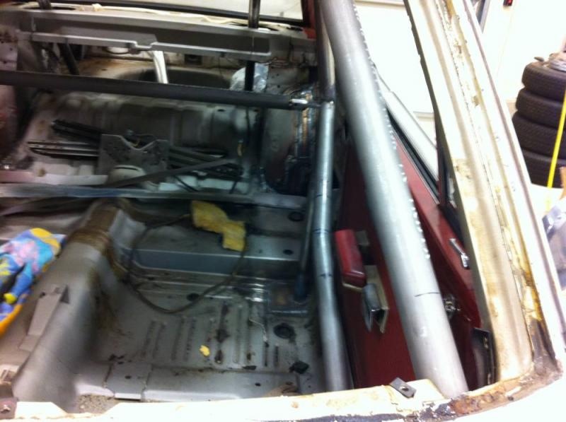

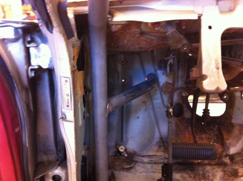

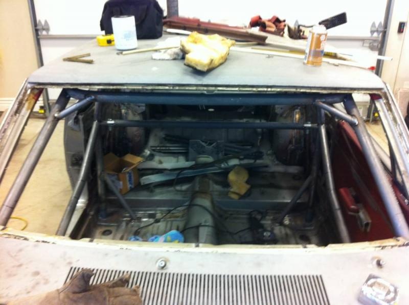

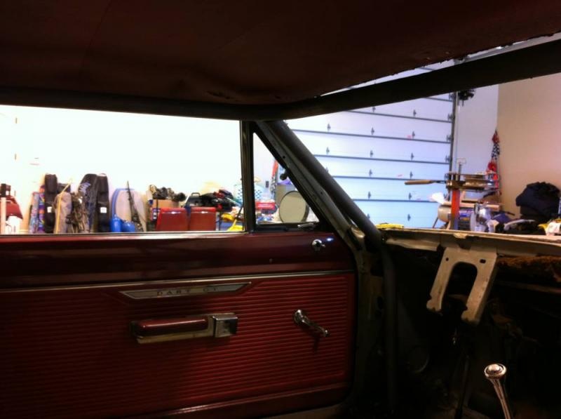

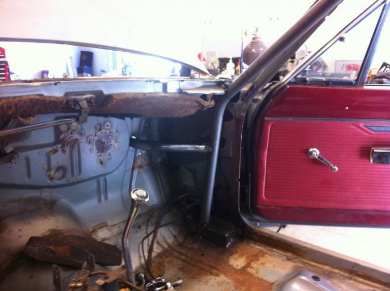

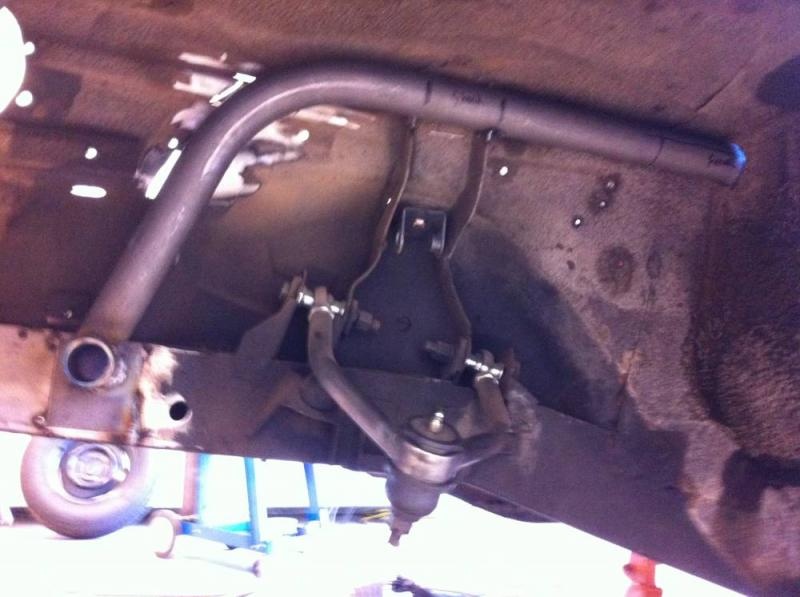

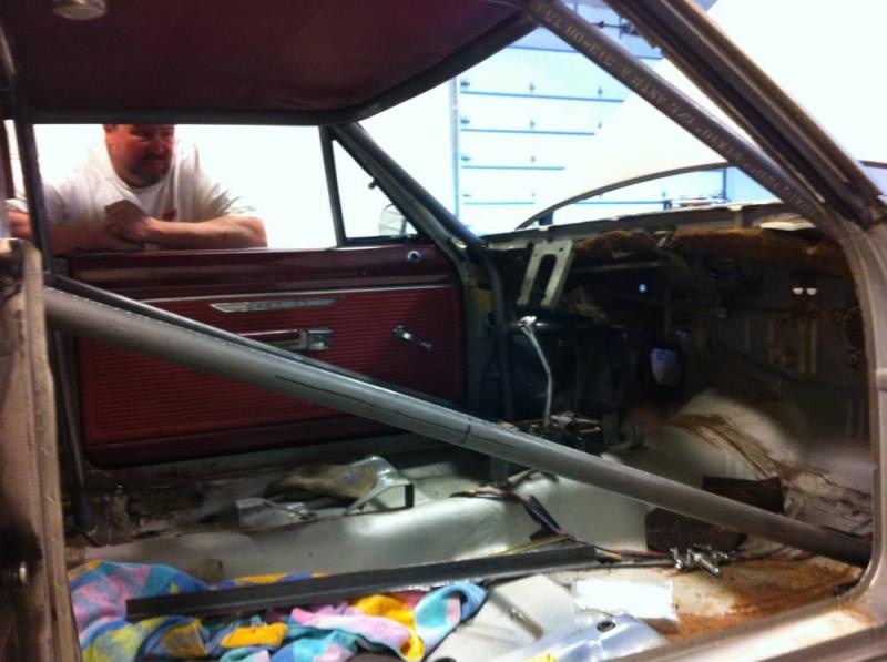

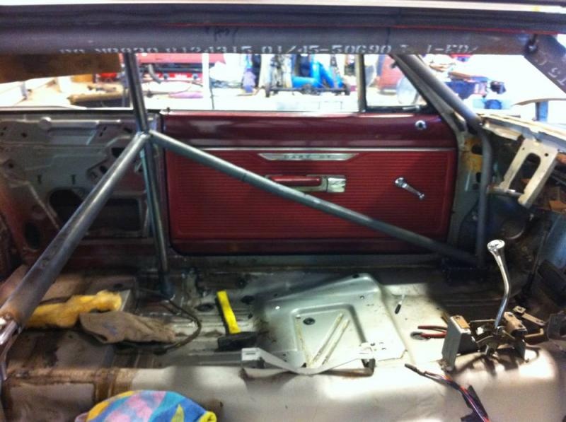

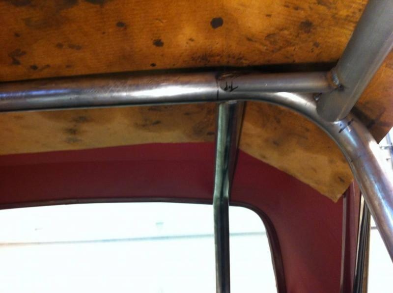

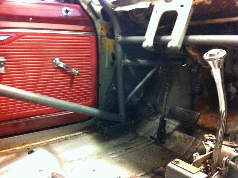

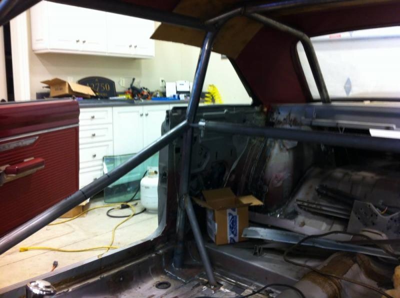

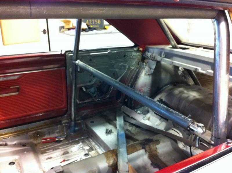

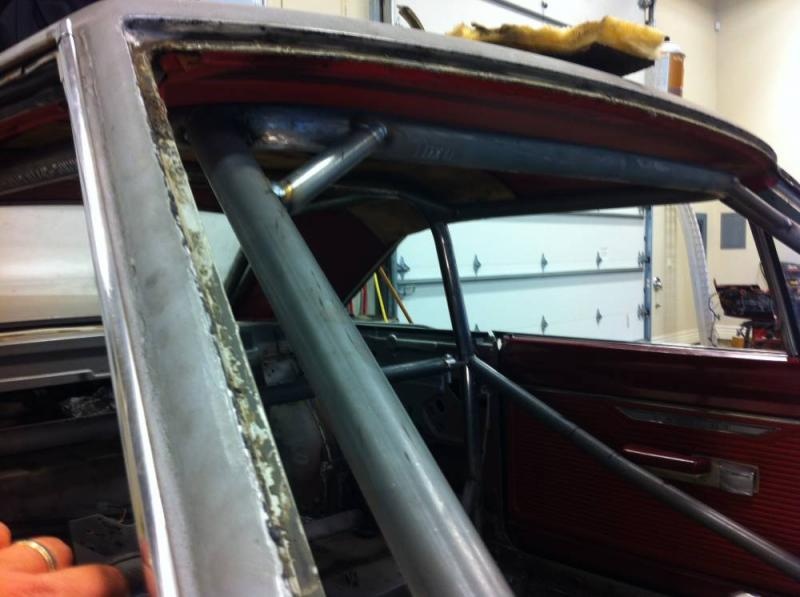

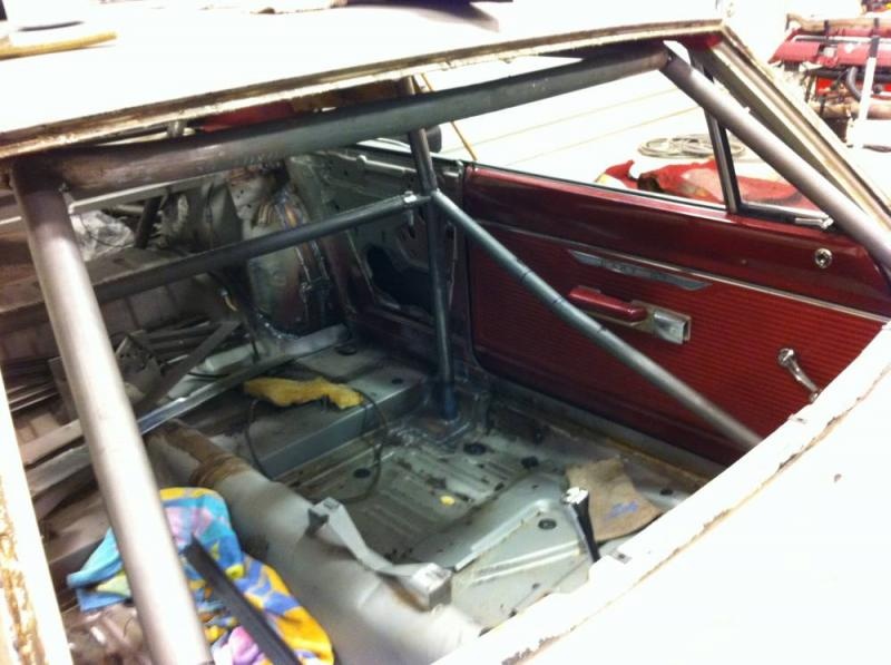

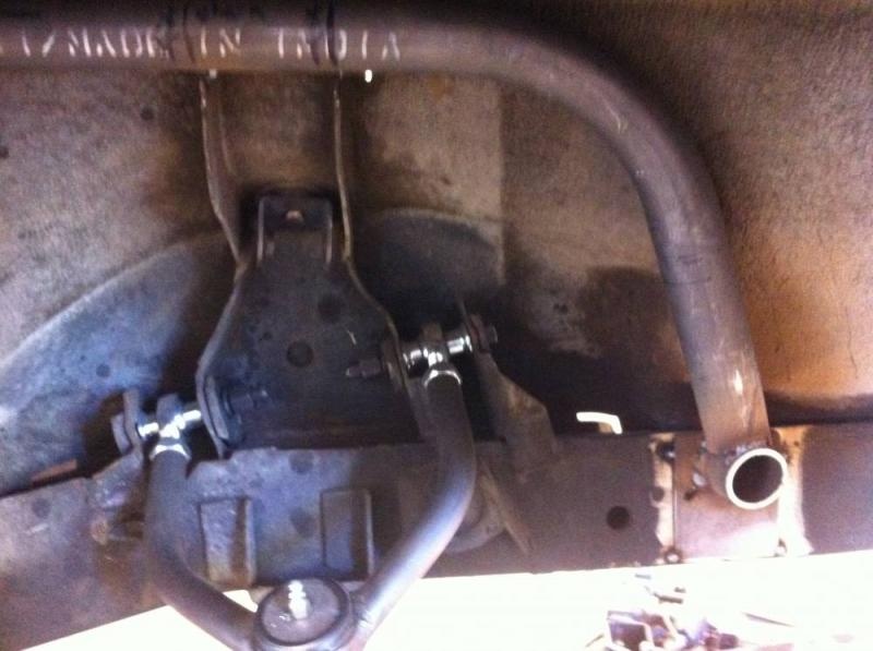

Wondering on the cage, why did you not make the tubing meet at the same places? Like the bar that gies from the main hoop to the subframe connectors. The halo to the trunk bars, the forward strut bars to the dash bar ect. Seems to me on an impact your asking for the tubing to kink the bar in-between two opposing tubes. And the bend in the forward strut bar to the a pillar bar seems like a bad idea to me. It's a weak point in the tube and on a front impact could bend and sever a leg or impale you. I'm not trying to be negative, just trying to find the reasoning behind it. I have seen a bunch of cages with bars similar (not meeting up at a common joint) and could never figure out why. My cage has all joints supported by another tube to avoid a kink in a collision it may be overkill but is there such a thing when it's safety? I know your buddy has built others, and the cage is well constructed as far as fit up, and design, but it seems like there are too many kink points in it. Are you planning on a getting a cert? I assume not, because I don't know your removable seat belt bar would pass. Again I'm not trying to be negative just trying to understand the thought process for the decisions made.
The guy that helped me with the cage has been doing this for 20 Years.
If you have a better Idea on how to do the Forward Strut Bars with a car that sits 3" Lower than stock and will be converted over to Coil Overs and not rub the tires AND has absolutely NO ROOM Left in the engine compartment because of Twin Turbo's Under a Stock Hood & Body, please point out how to do it. I am all ears.
Do you see how tight the tube is on the forward strut bars to the inner fenders?? It will be stitch welded to the inner fenders and All Penetrations that go through the firewall will be plated and fully welded off. Sooooo There is absolutely no way for me to get SPEARED or my legs cut off by that tube.

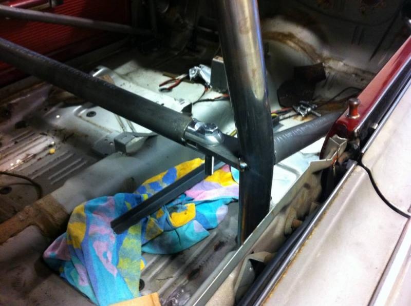

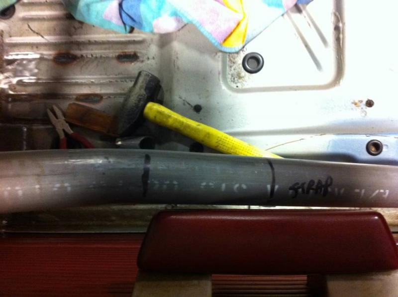

Yes the Removable Bar behind the seat will pass inspection as long as there are Grade 8 Bolts in it when you Race.
Yes the cage will pass certification to 8.50
I don't know how many cages you have seen but Most are built just like mine is. There are many ways to skin a cat. Also you are looking at a half finished job.
Here is a link to some more cages... You should go ahead and let all of us know your expert opinion on all of them. I will be eagerly awaiting your response to this thread.
http://www.forabodiesonly.com/mopar/showthread.php?t=183096
Hey man, I could be mistaken, but you took my post way out of context. It was not an attack I am just asking questions trying to figure out the reason for doing it like you did. I don't have the rule book on front of me and have nit looked at it in 6-8 months. So I'm going off memory, but I thought the seat belt bar had to be permanently attached to the main hoop. Again going off memory so I could have been mistaken. If so I apologize.
Next on the front strut I was not worried about the part in the wheel well I was talking about the part next to your legs. I can see it as a weak point in the cage if the front corner were to take a hit, it's possible for it to kink on that bend, as there is nothing there to deflect the force elsewhere.
Next I have seen well over 3-400 cages. yes alot of them are built similar and do not have tubes lining up. Yes they pass tech. I'm not disagreeing there. And I'm sure it's for the ease of install, as it's much easier to do but the transfer of energy could kink the tube between the bars. Look at the 25.3 and 25.5 cages they are very stringent requirements. All tubes must meet another tube. Granted we are talking about much faster certifications, but I do agree with it. Look to SCORE and CORE racing where the cages take a much larger beating than a race car cage, they are the same way.
Now my personal experience with my own cage, I tacked it all in place and took it to have it looked at by an NHRA inspector, and was told "my job would be so much easier if all cages were built like this" referring to the adjoining tubes. I was told weld it up and it will pass cert for 8.50. That was comforting since it was my first NHRA cage. (not my first cage by a long shot but first that needed a cert)
I'll repete my previous statement I'm not bashing or being negative I'm just looking for the reasoning behind the decision. I'm guessing from your post that you took in the wrong way. As it's hard to show expression in text only. Another guess on my part, (correct me if I'm wrong) is that you did it the way you did because that's how it's always been done. And that's fine there is nothing wrong with that. I was just voicing my thoughts on what I feel is not the strongest points. I don't have a solution as I don't know all the details and am not there to toss arround ideas. Just trying to help.
