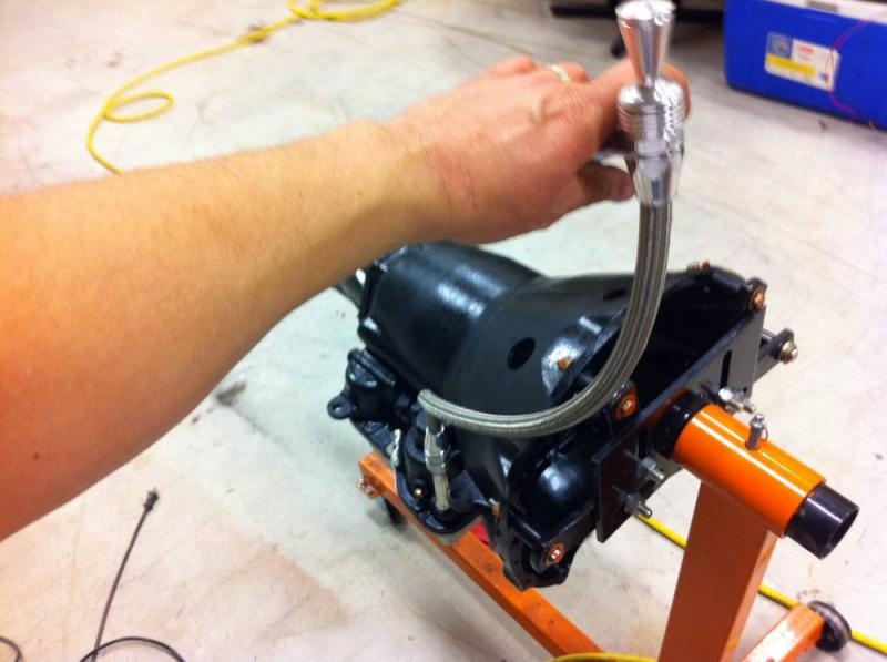

Just purchased a Lokar Locking Firewall Mount dip stick. I was going to go with the transmission "bell housing" mount version but I think the dipstick is too short to get around the Flex Plate Shield that bolts to the outside of the bell housing.

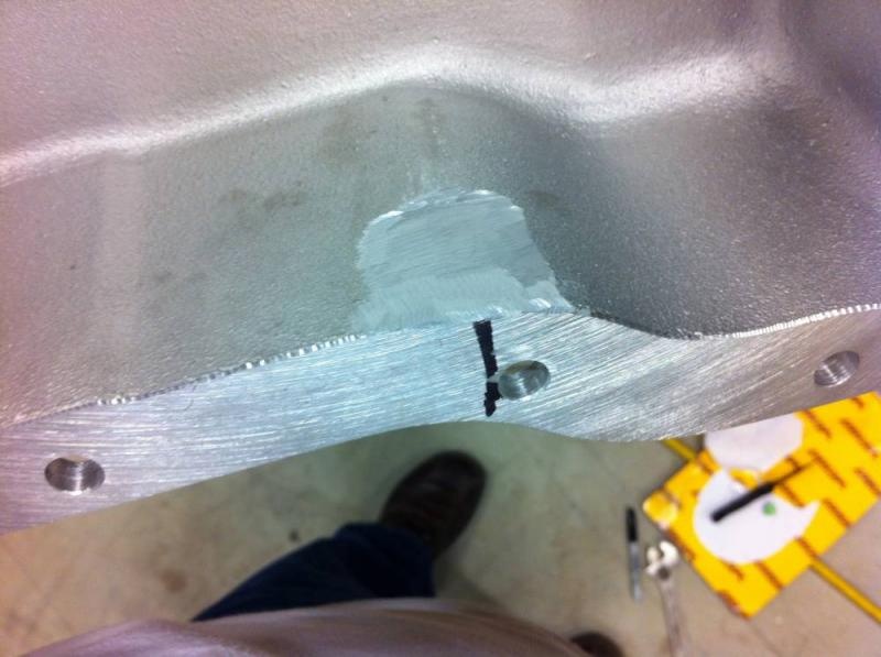

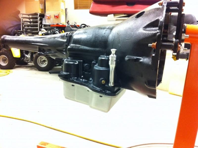

I got the Aluminum pan today so I installed it along with the Locking Lokar dip stick.

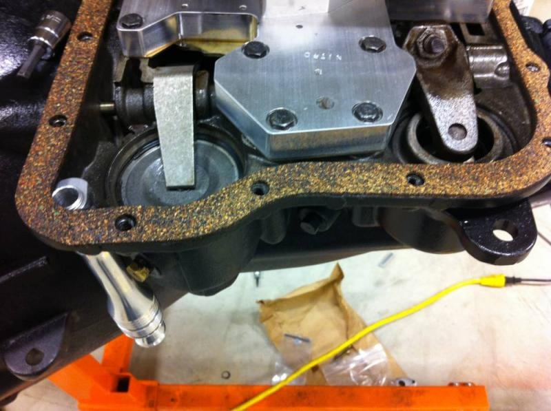

When installing the pan I felt it hitting something so I ended up having to clearance the inside of the pan for the Valve Body. The bolts would not line up either. All is good now.
There is a built in boss where the pan can be drilled & tapped for a Temp Sensor for a gauge or to connect to an ECU etc.
