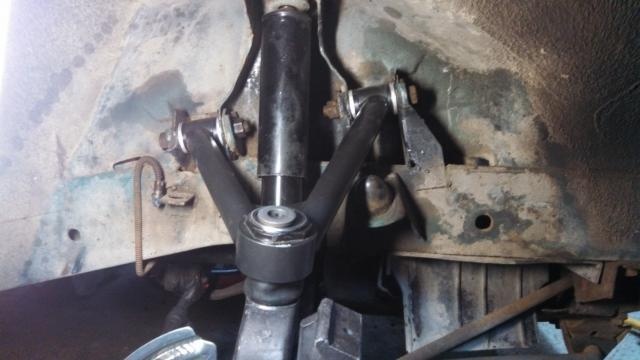

Updated pictures of the front end. Installation went well with the magnum racing tubular upper a-arms. It was a pain for the local Les Schwab to align but they got it and the car is totally different with the new tires, disc's, 11" x 2" drums in back! I will upload more pictures as soon as it stops raining. :)
