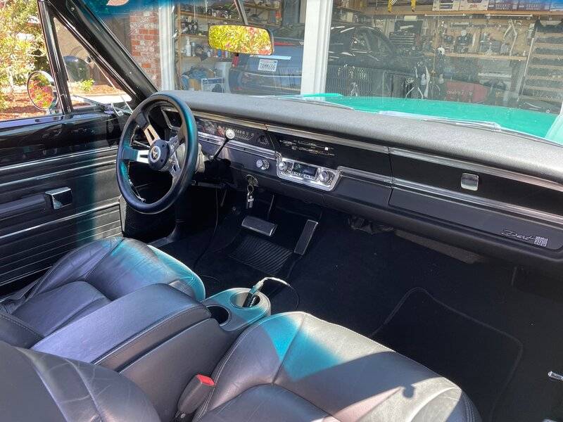

OK, Tommy, here are some after pics. As you can see there are some later model parts, 2000 Sebring convertible seats, '68 plymouth marker lights (working turn signals for safety), 73-76 style K frame, front and rear sway bars, heavier leafs and torsion bars, 8.75 posi rearend. The bumpers were really straight, just needed rechroming. I put in new glass, rubber, polished all the trim, made the "ralleye" rims from 1985 7" cop car rims. I used a Belvedere rear view mirror as it wider than the Dart mirror. So many projects over the past ten years...
Well done!! Your car is beautiful!! :thumbsup:

Oh, I think mine or 2000 seats, so yeah, I put the inertial switch in there. See: Chrysler Sebring convertible seats
I think fabricating mounts for the Dart was harder than for a Corvair, which has like a flat floor pan.
