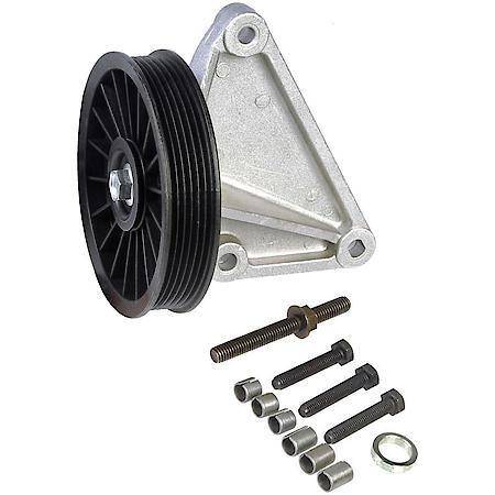

I'm running stock a/c bracket with no a/c. Still running power steering. I want to remove power steering pump/pulley.
My current set up in pics with stock a/c bracket, and p/s. I just cut the a/c side of bracket off. (Not shown in pic)
I'm running stock a/c bracket with no a/c and power steering. I want to remove power steering pump/pulley. My understanding is I have to run a 7 rib ideler that's smaller than my stock one to get belt to be good tention? And what belt was that again?
for that setup i would just locate an AC delete pully and run a stock idler
A 7PK1430 should be Dayco 5070563, and should be a 7 rib that is 56.3 inches overal length. That 6PK1410 should be the Dayco 5060555 which is supposed to be 56.17 inches overall length.
That small difference may be ok with your tensioner already in the middle of it's travel.
So I didnt know 1st number is rib count, that's pretty cool. But I'm pretty sure last 3 numbers are the inches Dayco 5070563, and should be 56.3.
Dayco 5060555 pretty sure would be 55.5 inches..
33 bucks. you can run stock belt and idler
