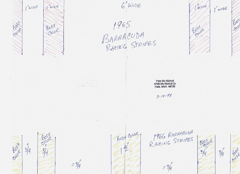

The stripping was a dealer "installed" (paint) option, not actually part of the package per say; you'll find cars with original paint W/O the stripes. Mine's an early '80s repaint, so I have no clue what whether it came with the strips from the dealer. The stripes also differed between '65 and '66. Here's what I have on them from Pete McNicholl, from whom I bought my '66 Formula S in 1991.

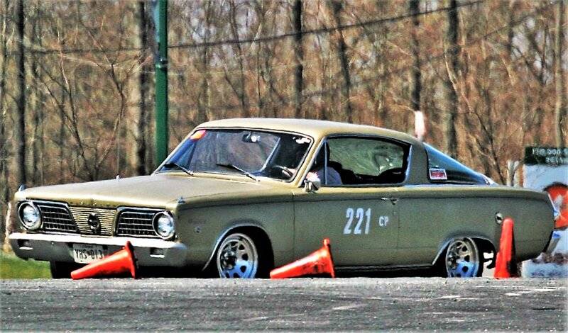

My old car (and Lilcuda's old car). NOT a Formula S, but had everything except the badges plus disc brakes. Commando, tach, handling package, discs, 14" wheels (although they were the 4.5" wide), four speed. It originally had a 7-1/4 3.23 rear, but when one axle broke on me I put a '67 A-body 8-3/4 3.23SG in its place. Also, not an original black car with black interior (what I changed it to). Last pic is what it looked like in 1981 shortly before I sent it off for paint. It was an original vinyl top car, as well.
