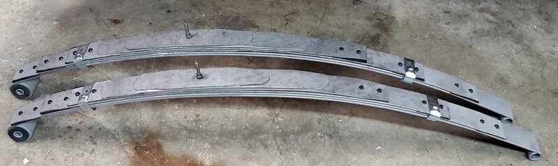

The original springs were six leaf. They are in my 67 Barracuda now (originally a slant six car), while the ones in my 65 are out of the Duster 340 my brother wrecked. They also are six leaf. (The Duster springs had a lot fewer miles on them than the 65 Barracuda springs.)
Why did you scrap them? I'm still running the original springs on the 66 and 68.
I disassembled, blasted these swap meet 340 springs and put them back together with new insulators and zinc interleaves for my 63 Valiant. Pretty much look and function as new. I did paint them before installing them. They, too, are six leaf springs.
