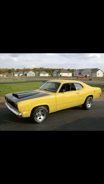

Below is my ‘71 Duster w/E- body S/S springs and 275/60/15’s and the wrong offset. I can’t remember exactly what the 8-1/2 wheels had for an off set, but the back spacing is IIRC, 3-1/2 or more inches. There typical wheels. From a Ford or a Chevy I forget.
It's all about how much tire you want to put in there. NHRA says you can not have tire sticking outside of the wheel well. Minnie tubs to the frame rail with the right offset rim will get a 28.5 x 11.5 M/T slick on a stock width axel with springs moved to the frame rail. you will have to clearance the inside fender lip, the forward rocker edge and maybe the rear rocker at the bottom edge..
Standard width a-body rear. Ralleys are 15x8 with 4 inch back space. 275 60 tires they will fit on your car with a factory rear
The weld wheels are 15x12 7.5 back space The rear is factory width The car is mini tubbed the the springs and wheel houses moved in three inches Tires are 29 14.5's.

This is a stock width 8.75 with 10 in. Centerline's, the quarters had to be trimmed for the drag slicks, it dosen't have mini tub's and the SS springs are in the stock location. 15x10 5 in backspace centerline, did have to use a 1/2 in spacer with 10.50 slicks to stop spring rub.
This is mine with a b-body 8.75 and mopar ss springs.

295 60 15 drag radials and 295 60d15 treaded slicks -----doesn`t touch anywhere , even at speed .
